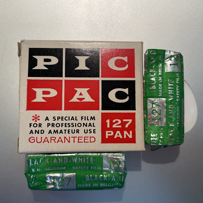

I bought these two rolls for the spools but I might as well expose one and see what I can get. From Belgium. 1967 vintage. 80 ISO.

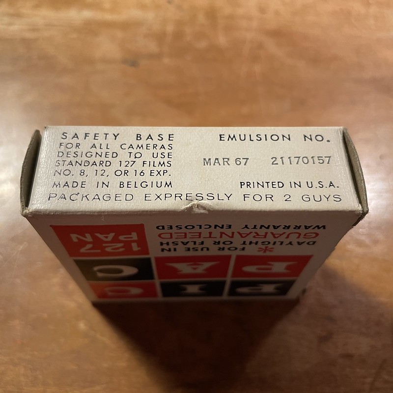

What does you make think it is from 1967?

I asked about the year as by 1967 the Gevaert plant long time was no more producing consumer films. Thus it may be one of their cine films.

What two guys was it packaged for?

The box says it's guaranteed, but it doesn't mention what exactly is is that they're guaranteeing. The lawyers were writing the copy even way back then.

Any ideas what Pic Pac could mean?
Donald Qualls
Jan 19, 2005
12,544
North Carolina
Never shopped at Two Guys, but I suspect it's along the lines of "this is the pack to pick." It was, after all, a two-pack box.

I found a photo of a Gevapan film dated 1967 and already bearing the post-1964 company name. As yours is dated 1967 and bears the pre-1964 company name, the film most likely is from 1964 exactly.
