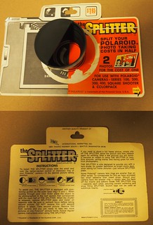

Actually, this is something that used to be done quite a bit to have multiple images of the same person in one photo.
For example, they used to make an attachment to put over the lens that looked like a lens cap, but that had a half-moon shape cut out of one side of it. You would put it on the lens, take a picture of someone standing on the same side as the opening, then rotate the cap to the other half, take a second picture, and there you are: Twins! I saw caps like this advertised as long ago as the 1920s.

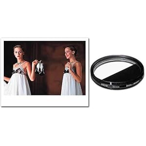

It's also a great way to shoot someone standing next to their guardian angel -- just double expose one half with them standing there only once.
Some folks got more creative than that -- constructing blind-type things in front of the camera with multiple openings so you could shoot the same person half a dozen times or more all on the same frame, opening and closing doors as they moved around. It took a little planning, but worked nicely. I even saw creations in LIFE magazine using this techcnique.
Photoshop has eliminated the need, but you can still play.
Is this what you mean? the dual image filter? looks like a lot of things can be done with it, looks promising
http://ecx.images-amazon.com/images/I/41+tWdXdujL._SY300_.jpg
