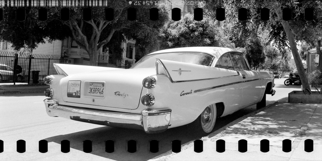

Can you post a picture of the sprocket holes? Are they the slightly rounded BH perforations? Just curious because Post #110 on this thread seems to show "standard" perforations:
https://www.photrio.com/forum/threa...00-35mm-x-100-ft-black-and-white-film.178140/
I haven't tried Ultrafine Finesse, but I have used ORWO N74+ before, which has the rounded BH cinema film perforations, as well as edge markings:
by dourbalistar, on Flickr
