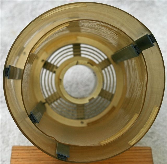

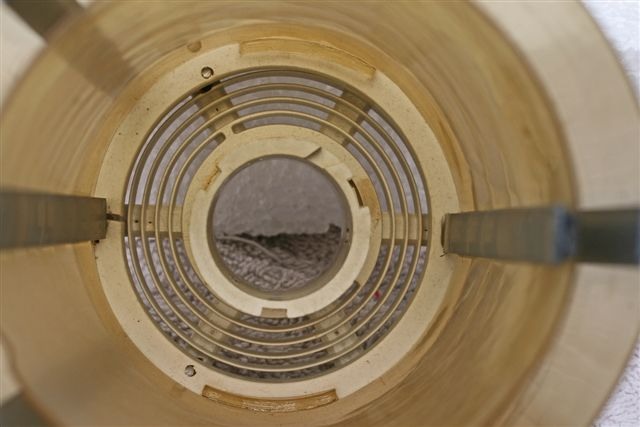

I have recently seen two eBay auctions of Phototherm units with 4x5 inserts that were made out of Patterson reels.
One currently listed is here: http://www.ebay.com/itm/PHOTO-THERM...784991112&po=&ps=63&clkid=7958399344643062561
Look at the eighth picture.
The one which recently closed, and I did not win, was for a broken unit. Here: http://cgi.ebay.com/ws/eBayISAPI.dl...sspagename=STRK:MEDWX:IT&orig_cvip=true&rt=nc
Look at the third picture, the unit on the left.
Has anyone ever seen one of these 4x5 inserts? Got any pictures? Can you make one at home out of things laying around?

I was actually just talking with the lab tech at my local camera shop about these. Apparently they were made by Phototherm using a generic plastic reel, cut to fit 4x5. It was a good concept, but he said that in practice the inner sheet would end up slipping off the reel, causing the two inner sheets to have uneven development and scratching.

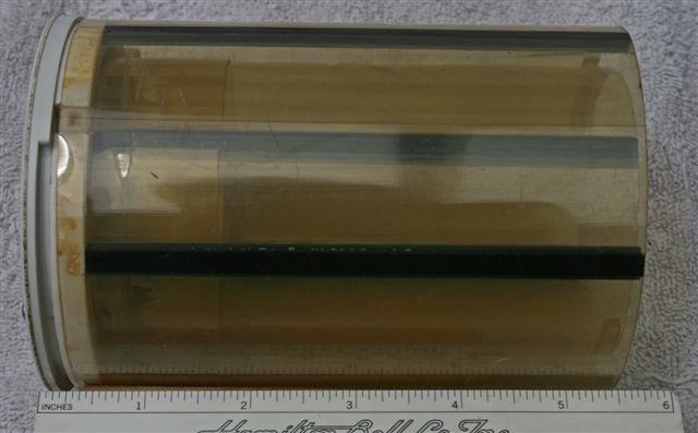

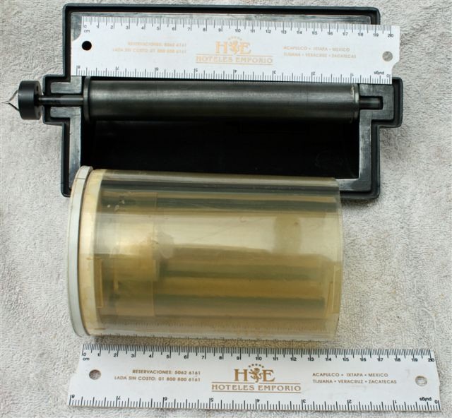

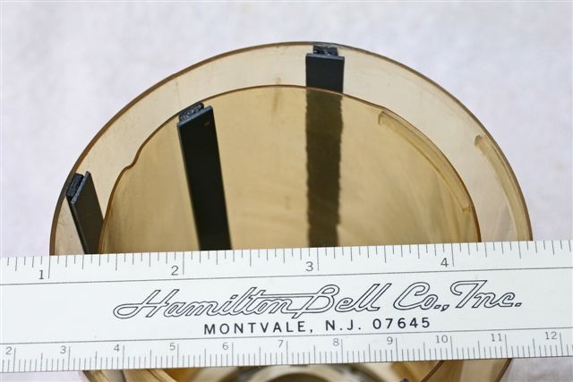

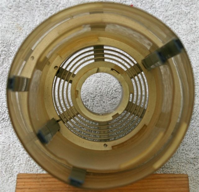

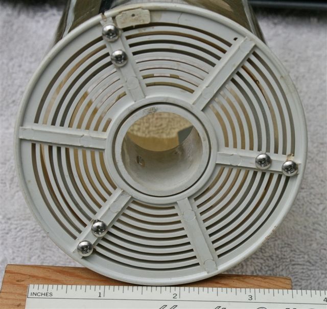

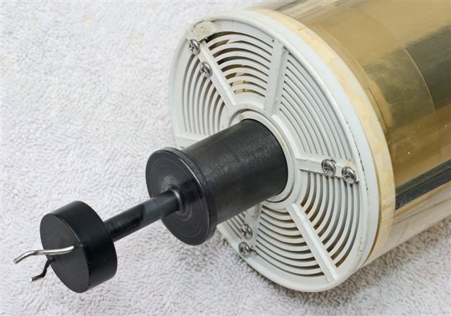

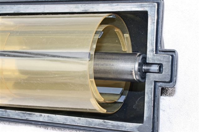

I just referenced this thread in another, so I thought I would come back and put in some pictures in case someone finds it in a search.
I did not win the auction I listed in the opening post, and after a while that item is going to crawl out of eBay's cache and vanish.
But I did correspond with the seller, and he was kind enough to take some snapshots of the reels before shipping them to the winner.
Here are some pictures.
