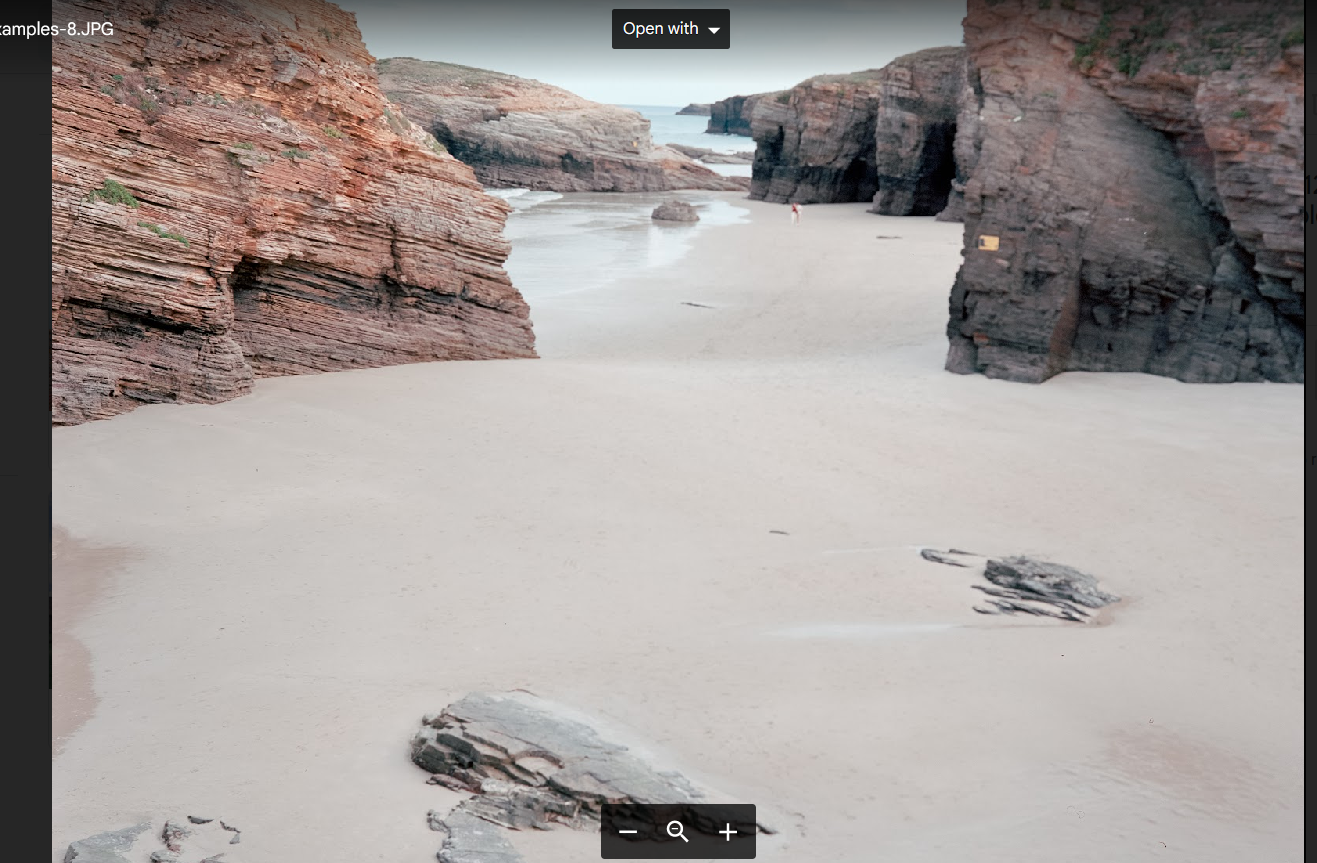

There's something odd, this is Image 8 or rather part of it.
Sharper on the left and way off on the right. Too far off for a film issue, I'd be looking at something way more serious lens alignment.
[image #8]

I really really really hope it isn't a lens-based problem. You'd think though that if it was, the soft areas would be consistent from frame to frame? Some of the frames I shared are totally out of wack, whilst others (such as #8) are only soft in one area. I guess it is possible the scissor tongs are not moving consistently, i.e., when unfolding the camera occasionally the linkage is not moving properly? Spitballing here...

Ugh, yeah, this is what I'm afraid of... is there a way to check the front standard alignment without specialized tools? I have some calipers here....

Just took another closer look at #8's neg - softness definitely in the capture. Not the scanner. I think next steps is shooting a test roll or two to track down under what settings this is happening and then off to the tech

The photo of the winding road tells a story. Everything is soft except for the rocks in the bottom left of the picture, a bit like you'd get using narrow DOF with a tilt shift lens. So it's either the front standard that isn't square with the back, or the lens elements are askew. The story repeats in post #6 with the top left sharp and everything else soft. Given that some photos are ok I'd say it's the lazy tongs that aren't locking or have play in them.
Indeed. The former is more likely, since this is a folder camera. I think I see both tilt and swing, so the lens seems to be non-parallel with the film plane along two axes. Perhaps deformation of the extension or locking mechanism. I'd inspect that area of the camera closely, and especially look for possible play/wiggling.
Interestingly, e.g. images 2 & 3 appear to show no lateral swing problem, whereas e.g. image #8 shows it very strongly, with the plane of focus running from the semi-distant rocks left to the much closer curve in the road on the right-side of the image. This suggests that either the problem is intermittent; i.e. the lens extension mechanism isn't reliable and/or has play on it, or the problem emerged halfway during the roll.
Given the tendency towards front-focus it also appears that the lens extends further form the camera than intended, although this could also be a rangefinder calibration issue.
Fix the lens board positioning problem first, then recalibrate the RF. I'd have a close look at those swiveling arms that extend the lens board.
I really appreciate the insight, folks. I have been inspecting these captures over and over again to try and find a pattern and I am inclined to agree with your assessments. It would seem at certain focusing distances the lens is going out of alignment, which is why I am still getting the occasional acceptable shot. By my estimation it seems like the top half of the frame is what is going soft, following almost a perfect split across the middle of the frame. If I had to bet I would say this is a problem with one of the two sets of lazy tongs not working perfectly in sync with the other, tilting the front lens at certain settings.
I must have knocked something loose in all the going we did on our holiday. The first handful of rolls out of the PM670 were stunningly sharp. Thankfully I was also shooting 35mm as well, so no memories were lost or anything. I think I will send it off to the wizcam fellow in Florida and get it checked over completely. Definitely a camera worth putting some money into to keep running.
