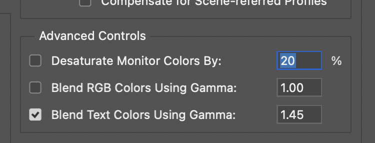

Maybe it's one of these? I don't know why they were set this way:

What you found, illustrated in post 8, is yet another manner in which the application might be adjusted, again different from workspace or profile.
