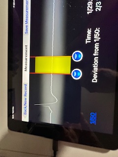

After reading about the Photoplug shutter speed tester, with app., it sounded like it was easy to set up and use, with reasonable results, assuming you set it up correctly.
So I set up a simple rig using my Sinar Norma kit to test large format lenses. My problems is that I am not getting a second peak, so am unable to position the second blue marker To enable getting a result.
I am sure somebody out there is getting results so any info about your own set up may help me.
There is no interfering light source, my light source is directly in front of the front lens. I have removed the rear lens. The sensor is inside the bellows, so the light that hits it is the light coming in from the light source I have set up. The sensor is plugged into a 3.5mm jack adapte, which plugs into my iPad charging socket.
Any thoughts, or am I just making it all too complicated.
HELP! please.

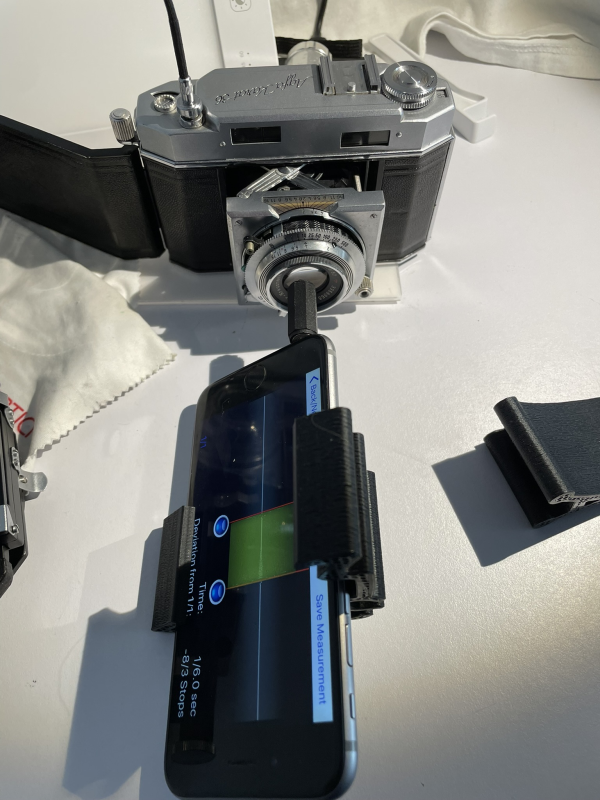

I have used the Photoplug for a few years and I think it is reliable up to 200
After that is very hard to find the peaks
PS I see you are using it in an iPad, I kept and old iPhone 4 for my photoplug

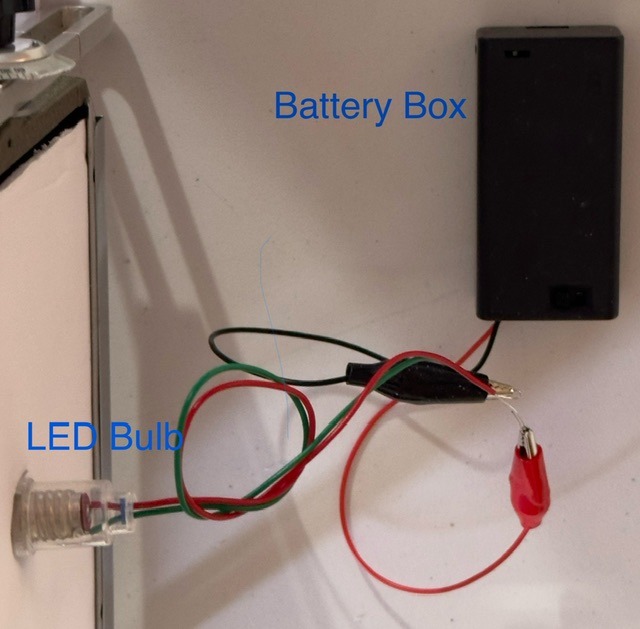

LEDs flicker. Use a tungsten light source.

The Photoplug uses the iPhone's microphone input to convert the light signal to an electronic pulse, so it "looks" to the iphone like a sound. You absolutely need a plug and a jack that have 4 connectors, because the 4th connection is for the microphone. The mic is the ring closest to the base of the plug, the ground is next, and the audio L and R output are the two connectors closest to the tip (which the Photoplug won't use). If you use a typical stereo plug/jack with 3 connectors, it will ground the mic and you'll see nothing.
I have a homemade photoplug (the electronics inside are not complex). It does work with iPhone 4 and 6 with a 1/8" jack. I have not tried it with a 1/8" to Lightning adapter.
The Photoplug should work with a focal plane shutter, though it will only give you one reading, so you can't measure uneven exposure (curtains moving at different speeds).
I recommend testing it at some intermediate speed like 1/15. For fast speeds with the Photoplug, it may take a little experience to separate the peaks, as the plug+mic response time brings them together. You can also test the app on a leaf shutter in sound mode without the plug; it should work ok at 1/30 and slower, but faster than that it is hard to separate the sounds of shutter opening and closing.

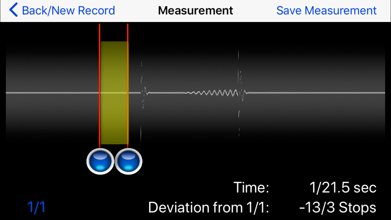

It would be helpful if you posted a screenshot to show what waveform you are seeing. It's really much easier to debug this kind of thing with pictures.

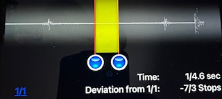

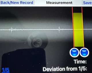

Hello, these are the wave form I have been getting yesterday and it was the same shape for each shutter speed. After following advice and suggestions I now have different wave forms but I am “blowed” if I know where to properly position the blue marker dot.
Perseverance is the key, as it is important. If we can measure something, we can control it.
I’ll double check I wasn’t dreaming them, then post the photos of the different wave fIMG_2225.jpegorms later today or tomorrow.
Note, in the photos, I have shifted the dots out of the way so the wave shape is visible.

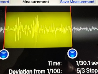

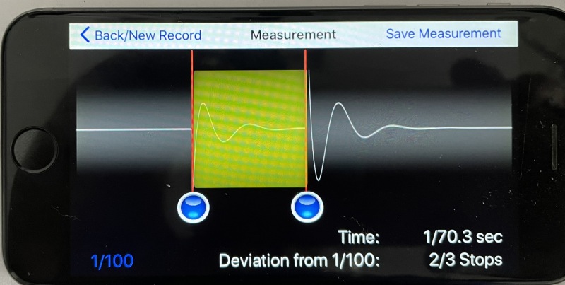

your wave form looks really strange
This is what I got
Tthen you move the blue balls to the beginning of each wave

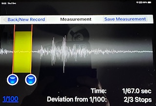

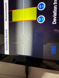

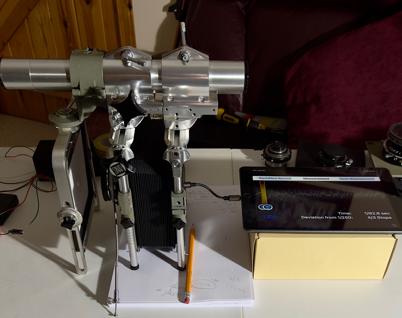

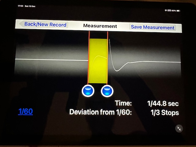

Hello, do you have a photo of your set up, and what light source did you use? Do you take the measurements in the dark? Some of my wave forms taken since stripping my rig down and starting again. But I am still not happy but it is a lot better. Looking at the 1:100 , where do I position the dots?
It’s time for me to review all that I have read here and summarise. I will then test my next lens.

I use a flashlight on the backside and the photoplug on the front side
I have used the otherway as well, but it is easier to balance the flashlight in the film chamber for 35mm and 120 film cameras
In your case a flat panel can fill the back of the camera and illuminate towards the front of the lens
I use a relatively dark spot where the flashlight signal will be way above bkg noise
The manual says to chose be beginning of each peak, zooming in you can see something like this

With everybody’s help and some online reading I have finally got a set up that works
, thank you. I have made notes of my process, and equipment used, which I may post if anybody is interested?
