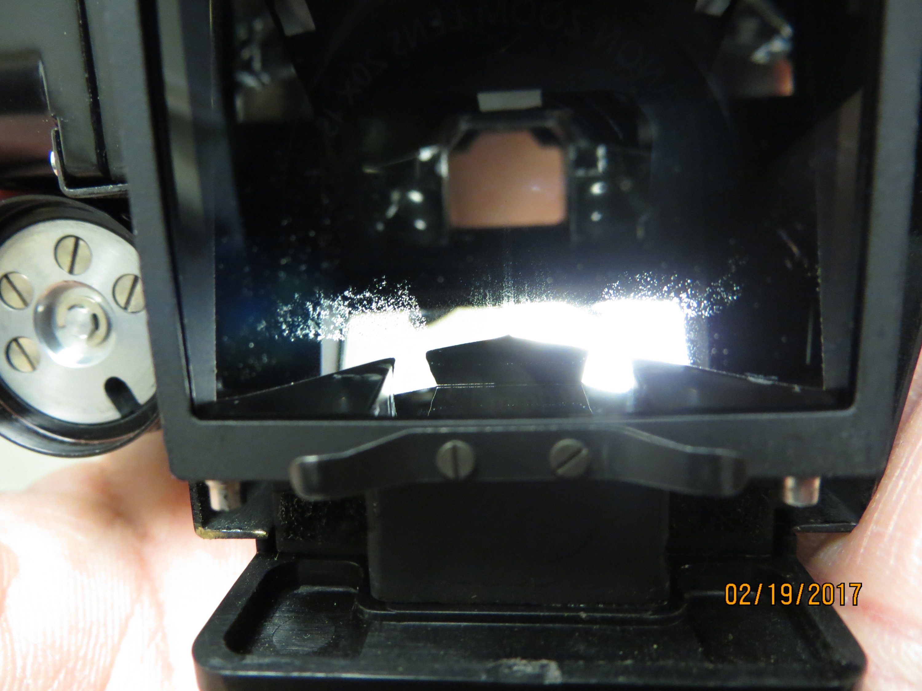

My new Nikon F TN is all cleaned up and being put through it's paces but there is a nagging issue that is concerning me. After carefully removing the handful of lint and debris from the focusing screen I have a clear viewfinder with the exception of what looks like either fungus or de-silvering. It is definitely inside the finder prism. Here is an image of what I am seeing.
Oct 3, 2016
102
Boise Idaho
I can live with it as long as it is only de-silvering. But if it turns out that I have a fungus problem, need to take care of it and separate it from my other equipment. The picture is deceiving. The right side is the reflection of the left side in the prism. While looking through the viewfinder I see it at the bottom left. I have avoided fungusy equipment till this point and am not really sure what it looks like. Would expect it to be sort of a spider web pattern if it was fungus. It looks to me more like a powdery residue.

My new Nikon F TN is all cleaned up and being put through it's paces but there is a nagging issue that is concerning me. After carefully removing the handful of lint and debris from the focusing screen I have a clear viewfinder with the exception of what looks like either fungus or de-silvering. It is definitely inside the finder prism. Here is an image of what I am seeing. View attachment 173383
There is fungus on the side that faces the focusing screen. This can't happen on the inside of the prism, because it is by definition a solid piece of glass.
As for desilvering, it is too common on Nikon F prisms. Just ignore the desilvering problem. I always wondered if Nikkormat prisms could be used as substitute!
So if I am understanding , you are of the belief that it is desilvering and NOT fungus? I can live with the desilvering.

I just found a tutorial online that explains how to disassemble the photomic heads. It explains that the foam spacers used would degrade and damage the prism over time. An image showing the rotten foam and the pattern it leaves matches the pattern in my viewfinder to some degree. I am now of the belief that it is in fact desilvering. I will just live with it. There is no way I will ever pay $300. + for a plain prism head. I don't think I will ever try to get the TN meter fixed either. I had every intention of using this camera completely manually to begin with. Just didn't like the idea of fungus spores in my equipment.
