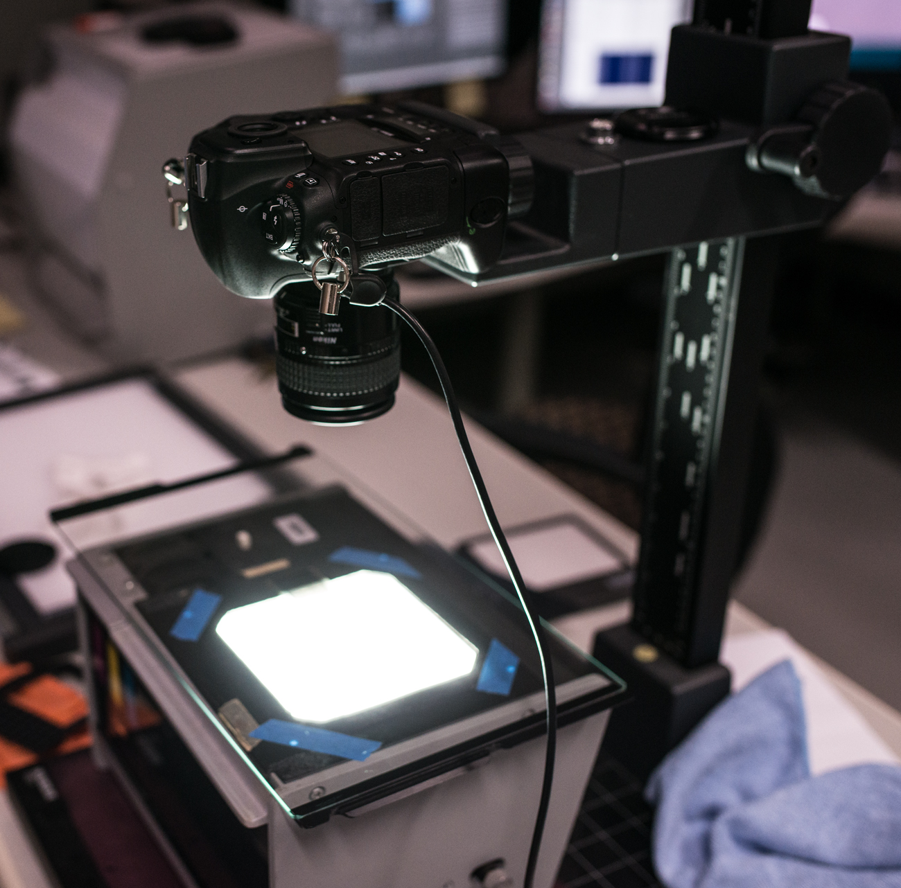

The filters in color heads only cover a portion of the light path. They need a mixing box to make the light even, so they would only be good as a light source; you can't pass focused light through the head to make a picture. If you try to take a picture through the dichroic assembly of an enlarger head, it will act like a graded filter. That is, only one edge of the image will have the color.
A common non-darkroom use for color heads is a light source to color correct (or manipulate) copies from slides (transparencies). Either by copying with a film or digital camera.
Picture shows an enlarger converted to a copy stand and a Omega Chromega D Dichroic head used as a light source for slide copies (no slide is present in the picture, but it would be above or below the glass).

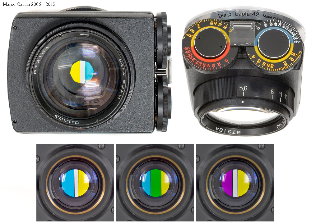

If you were to place the filters exactly at the nodal point in the lens, you could get a more even coloration. This was done with the Janpol enlarger lens (which may be adapted to a 35mm camera for close-up photography.)
why close up ? What is the price of that lens used ?

Close-up because if you want to focus the lens, you will need a focusing bellows and it may not collapse enough to get infinity focus. For example minimum extension might be 50mm which needs to be added to the flange distance of the camera (46.5mm for Nikon). This total needs to be less then the "Flange-Focal" measurement of the lens (for example 77.5mm for a 80mm Schneider Componon-S; unknown distance for the Janpol)
