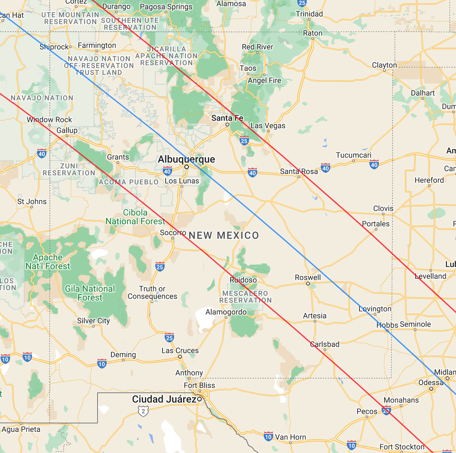

This is the path over New Mexico:
One of the best places in my state would be up north in Bisti Badlands or Ah-Shi-Sle-Pah in the north western part of the state, but that would be a bit of a drive. So too would be Shiprock. But Salinas Pueblo is pretty close to the blue center line, and has some nice ruins and I can get there in about 3 hours driving (and the way back takes me past the Owl Cafe in San Antonio, NM!)
