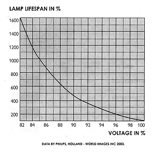

Sorry that my first post here is a question. I have an idea for lighting using No1 and No2 photofloods, I was looking into a classic "Series Parallel" switch (but remotely controlled with a relay) and then I realised that I can get a really rather good DMX controllable dimmer pack with four channels for about £80, which is far better for my purpose.
Google has not been kind to my search for a photoflood data sheet. What I would love to find out is how long a 230/240v photoflood will last when driven at 50% of it's capacity (so say 120V or a chopped PWM of 50%). I tried GE and Phillips but with no luck .. Does anyone else have any information they could let me have.

Some info I have on enlarging lamp voltage:

Until LEDs became economical, I used 40 and 60 Watt household incandescent lamps in series as a fairly bright night light. The 60 Watt lamp glowed a dull red. The 40 Watt lamp's output was greatly reduced, but sufficient for the purpose. It lasted up to 3 years at 24 hours a day before failure. The 60 Watt lamp never burned out. I neglected to meter the light output or measure the voltages across each lamp.
Many years ago we were plagued by short lamp life in 16mm movie projectors. Wiring a 6.3 volt transformer as a 6.3 volt step-down transformer at least doubled lamp life.

With tungsten bulbs like photofloods, I don't think data charts will be very accurate anyway. Ever notice that 90% of the time a bulb burns out, it's when you switch it on?
If you keep tungsten fixtures on dimmers and bring them up with the knob vs. switching on, they'll last far longer than spec'd. As long as you don't move them when they're running (you can move them carefully but a good enough bump when powered can break the filament). And running them at half power could extend their life far longer. I dunno if you'll find data that specific. Just stock up on spares!

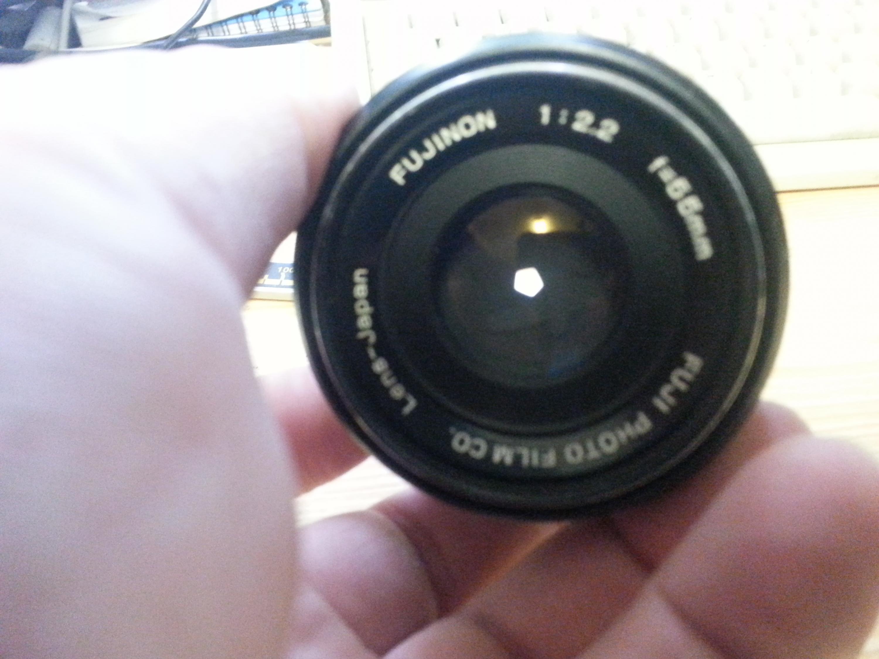

I've never done that kind of work, but when I've played with time lapse on my DSLR, I at least learned to do the unlocked-lens thing to maintain a constant aperture! I was amazed how much flicker you got just from inaccurate aperture closing.
There are many people who find the concept very difficult to understand, of course for stills it's not important as a 1% variation in exposure between frames is not even slightly significant. There are lots of solutions, and the only one I refuse to use is the "Unlocked lens" or "tape over the contacts" thing ..
On "Corpse Bride" they were originally going to shoot on film but changed to digital stills at the last moment and in the first set of camera tests (Using Nikon cameras and lenses) they had flicker in the background. The problem was solved by a chap called Andy Bowman who removed the stopdown pin from an AIS lens and this stopped the flicker. (Then they moved into another circle of hell entitled "Power supply issue flicker"). My favoured solution is Nikon AIS lenses on a Canon body and the aperture sets itself and stays there (of course my actual favoured solution is a Mitchell with a Jackson Woodburn motor and a Nikon mount, but I've not shot with film for about six months.)
Or this .. a lovely lens I got off a Fuji STX camera I bought at a charity sale for £5 with a £1 M42 to Canon adapter .. 2015-08-23 09.58.34.jpg

That's a good solution, my first DSLR video work was with Nikkor primes on a T2i. Sold the 2Ti when Nikon got their video look together though.
