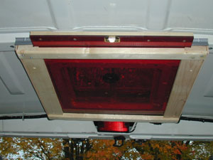

I'm making progress on the photo van. This is a Ford F 150 cargo van. The model with no rear windows. This has film and wet plate capabilities. The vent is in the rear near the rear doors. I installed 4" blackout vents in the bulkhead for a passive air flow. Ether doesn't like electric fan motors. And the red plexi will only be closed for a matter of a minute or so. (there was a url link here which no longer exists)

Ray it is in order to take wet plate on the road. Plus it can function as a rolling film darkroom also. In order to do wet plate the plate must be processed as soon as it is shot. Plus you need darkroom capabilities in order to sensitize the plate before you load it in the plate holder. I can actually process ULf film in there and contact print albumen or Pt/pd prints on site if needed. As Long as the great point light source in the sky cooperates.

Here's a little better pic with the black plex closed. When doing wet plate the red plexi will be closed and act as an additional darkroom light. Wet plate is blue sensitive.(there was a url link here which no longer exists)

Red plex in place but it is dark out.(there was a url link here which no longer exists)

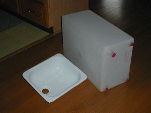

Next I'll install a sink with 15 gallon tank & grey water tank with counters and silver bath holders.

If you have room, you might consider a large water tank. My wet plate camper has a 22 gallon tank and I sometimes find that barely enough for an outing...

Kerik, I already have a 15 gal tank.. that's what the determining factor is. I kind of figured I could carry an extra 10-15 gal. for refilling if needed. This was a design/build on the fly, using the parts and materials on hand. It was Kendrick's trailer and your camper that inspired me. Thanks, Robert

Robert, How did you rig up your water tank and how are you installing a wastewater holding tank?
For my mobile wet-plate work, I have a cargo trailer that I have converted with an air conditioner, a vent like yours with ruby lith for a safelight and insulation on the roof. I use an office chair because the ceiling is too low for me to stand in. For a sink, I bought a cheap, plastic laundry sink. All but a couple of sticks of wood were surplus lumber I had laying around and I scooped up a set of metal shelves left on the side of a road to store trays and other paraphernalia. I painted the floor and walls with a can of gray reject paint.
I usually drain the water into a bucket and have to admit that if I'm on a parking lot I just let the spent developer and wash water run onto the pavement. For water, I either buy a 2-gallon plastic container with one of those spigots but I'm about to buy a 5-gallon container used for camping.

Bruce, Here is the sink and fresh water tank I have. The sink is 13x15x5". The tank is a 15 gal. For grey water I plan on buying one of those off of ebay that have the two wheels and collapsable handle. The waste water tank I plan on having nearest the rear doors with a hinged door that will allow it to flip open and roll the tank in and out. (there was a url link here which no longer exists)
