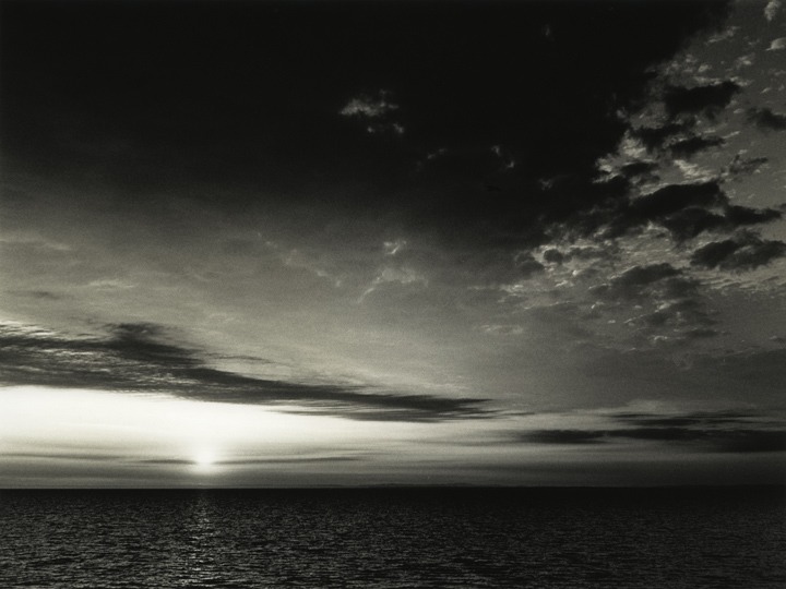

Arista EDU Ultra is really super nice paper. It's actually Fomabrom Variant 111 (glossy), 112 (matte). Beautiful stuff that prints with awesome blacks, and a slightly off white base for warm highlights, particularly in dilute or Warmtone developers. It tones incredibly well if you're into that.
Here's an example of the matte version. ImageUploadedByTapatalk1343358031.584714.jpg
Really like your image Thomas, that is the look I have always wanted to capture. Could you explain Warmtone developers, is that a brand bought off the shelf or something that must be cooked up? I spent 2 weeks with my daughter, she uses Kodak chemicals and mainly Ilford paper. She got me comfortable with the enlarger, but we could use the same negative and developers and hers always looked better:^)
Warmtone developers - I don't know how to get there chemically, but Ilford makes one, you could use Zonal Pro Warmtone, which is like Ansco 120, etc. There are chemists here that know far more about that than I.
The picture I posted is basically just to insure you that even with budget paper, like Arista EDU Ultra (fiber) you can make prints that are very good. Believe it or not, once you have chosen your paper, this remains a constant in your system. Developer is likely best kept the same, at least to begin. But to really reap the benefit of the paper, you need to make good negatives that print well on that paper. That is the real secret of all of this.
