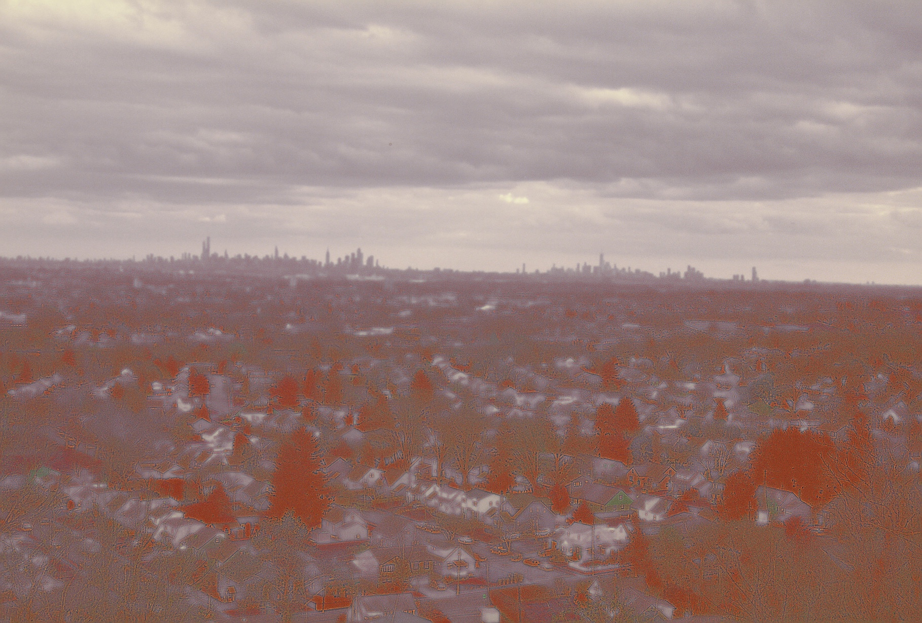

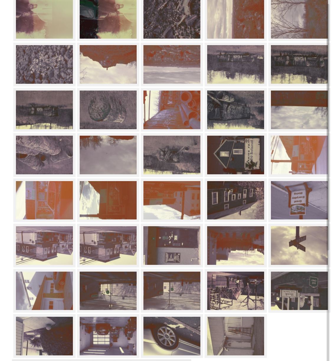

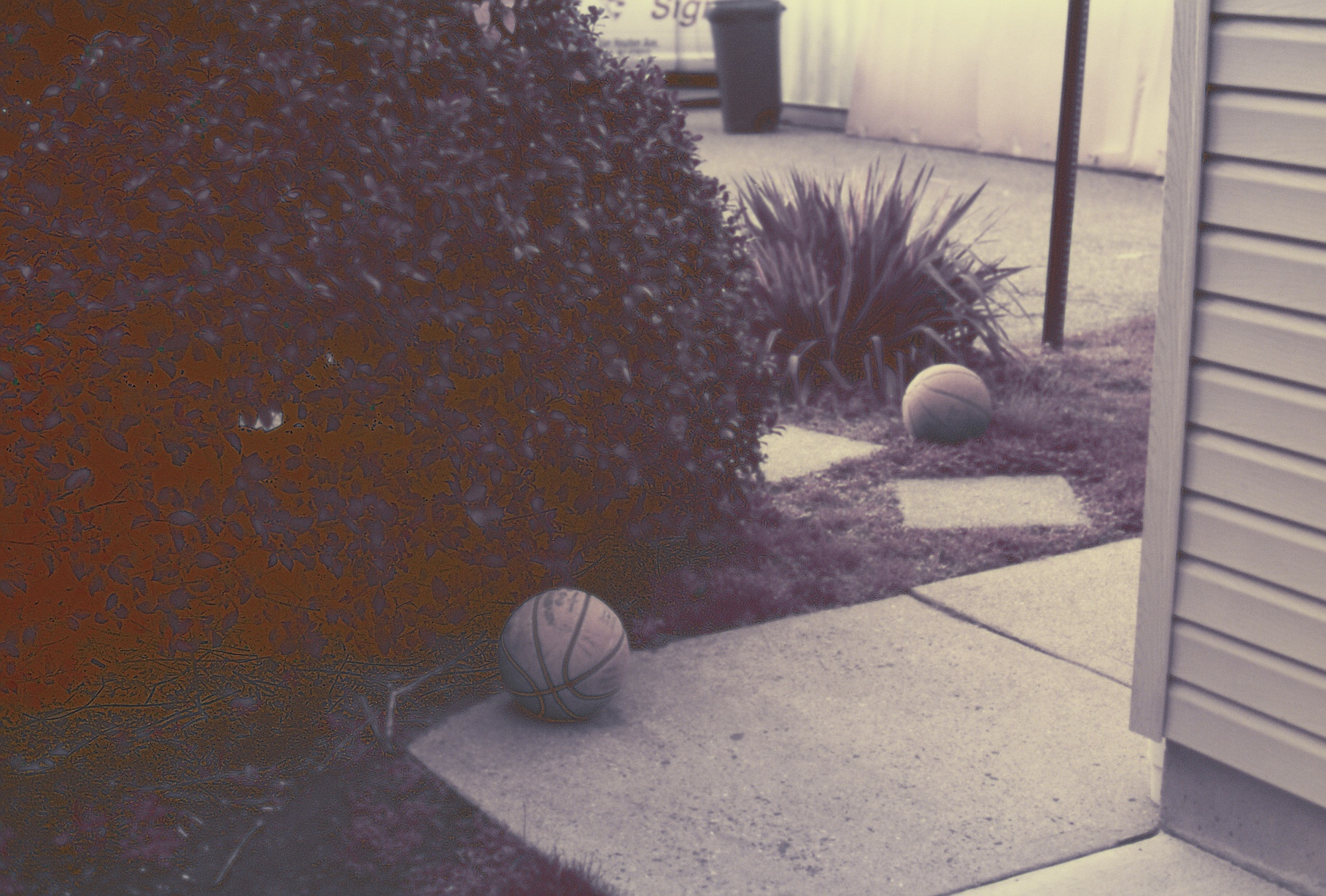

Hello - first time poster here. I was referred to this site from a Reddit post I made regarding this roll of slide film I had developed (Ektachrome 100). All of the scans I received were orange/purple tinted and had some sort of texturing/halation. I called the lab and they said it seemed like the batch used some sort of old/expired chemicals or something. I was told that there may be a chance to fix this by having the lab redevelop it somehow. I’m not very educated on the process of E-6 developing but I was told it may have been a fixer issue or lack of bleach? If anyone has any ideas of how I can salvage this roll I can pass it onto the lab and hope for the best. All suggestions appreciated, and thanks in advance!

Unfortunately, with the silver gone (via bleach and fixer), there's nothing that can be done to correct these. Even if they'd been bleach bypassed (or incompletely bleached), attempting to redevelop would result in no additional dye formation, because the first developer would develop all the (fully fogged) halide and nothing would be left for color developer to do. Going directly to color developer might produce additional density if there were a case of no/incomplete bleaching, but this would generally appear in a form like fog (dark, in this case, because it appears after the skipped first dev step). And there's no practical way to remove the dye formed by color developer, even if there were imagewise silver to redevelop, so anything that might be produced by reprocessing would simply be added (by absorptive addition) to the images you already have.
Bottom line: these slides are toast. Under their warranty, your lab owes you a roll of the same film, and reasonably ought to offer free processing for that roll as well (in an attempt to keep you using their services).
For myself, I'd recommend you consider doing your own E-6. The process has more steps than C-41 or B&W, but isn't really harder -- you just have to follow directions the same way you would for other film processing.

138S
Dec 4, 2019
1,776
Pyrenees
Perhaps the dark orange opaque stains can be removed, but the defective color has no solution IMO beyond what you would do in Photoshop.
IMO it is not clear that a "redeveloment" would do something, only in a few cases that has an effect, for example if processing was totally interrumped at some point. If an step partially or totally fails but next steps are performed then information is "cleared" and it cannot be recovered...
If you don't have very important images there then forget about that roll, personally I'd try with another lab...

Could be just a problem of just silver retained by an incomplete bleach, it decrease color saturation badly. The terrible look of the shadows could more related to a scanning with dust reduction activated, it works very bad if there are silver grains in the image.

Looking again, this could be silver retention due to failed bleach; if that's all that's wrong, repeating bleach and fix steps will solve it.
IMO color development failed before bleach happened, color "destruction" happened at color development stage or earlier...
"Variation in color developer pH causes color shifts on the green-magenta axis with Kodak E100G & E100GX and Fujichrome films and on the yellow-blue axis with older Ektachrome films."
Probably several chem baths were destroyed, the color problem had to be originated before bleach, while the orange opacities are from the next baths. Probably the processor had total crap chem inside, this is not an slight color shift... not easy to perform such a botched job, an explanation is that they reused chem dumped time ago, it is diffcult to have such a crap of chem inside a processor. Another possibility would be a big mistake in the mixing, but as Lab speaked about expired chem...

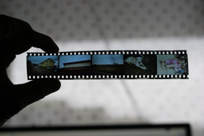

I am probably too late this the discussion but can you post a photo of your transparencies?
If not mounted then something like this.
