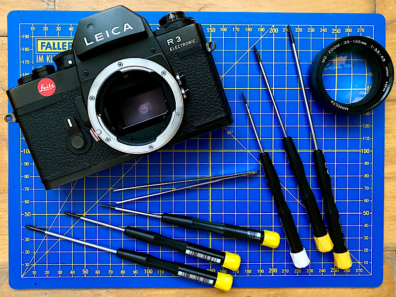

Equipment for getting started
To start, I suggest:
  • a broken device for practice that ideally corresponds to the one you want to repair later; any other photo device is also suitable, except for flash units and cameras with built-in flash (due to the risk of electric shock),
  • for older Japanese cameras: ideally JIS (Japanese Industry Standard) screwdrivers and slotted screwdrivers. For the JIS screwdrivers, I work with sizes 0, 00 and 000. For slotted screws, my largest screwdriver has a blade width of 3 mm, Recommendations see below;
  • tweezers to be able to grip small components securely,
  • a magnifying glass (a 50mm lens in retro position also works well),
  • bright workplace lighting,
  • a clean flat surface to work on.
For the time being, it is not about solving a problem, but about opening and getting to know the practice device and whether you like it.
Mistakes are also meant to be made, also to get to know things, that happens all by itself 🙃
  • Slipping with the screwdriver and leaving scratches,
  • damaging sensitive components,
  • looking for small components that have fallen under the table,
  • mixing things up and installing them incorrectly,
  • losing your bearings.
The first experience with the topic of DIY is important, no matter what it looks like.
Then you have already taken the first - most important - step and can see whether you are still interested, whether it was fun and whether you are interested in further discoveries.
JIS screwdrivers for older Japanese photo devices
The JIS screwdrivers fit the Japanese cross-head screws in older Japanese photo devices and prevent the screw head from being overtightened and thus damaged.
I am a fan of the Japanese manufacturer Vessel and can recommend these screwdrivers:
The longer screwdrivers give you more torque, while the shorter ones give you more control for finer work.

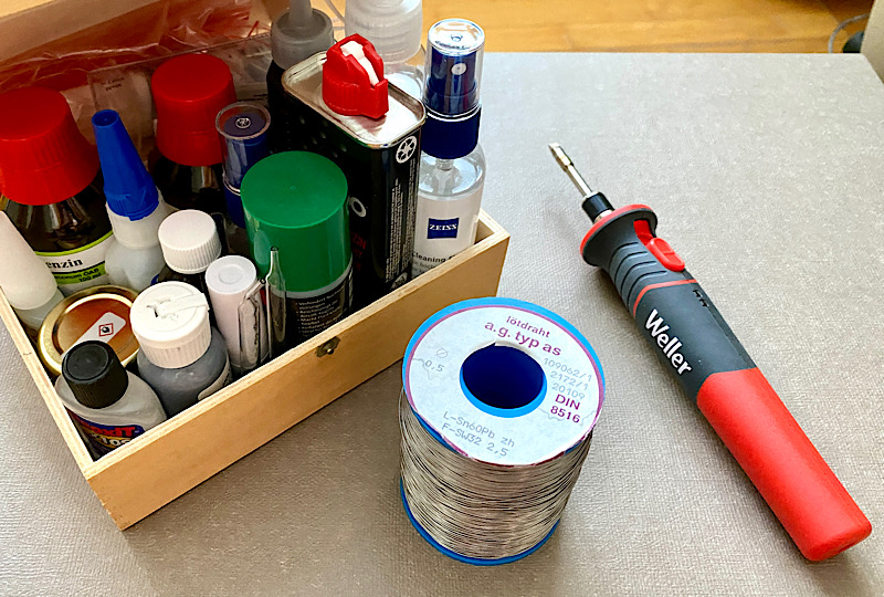

Chemicals and soldering
Advanced work involves working with solvents such as isopropyl alcohol, petrol or acetone. You can use them to clean or dissolve adhesives.
These substances are flammable and should not be inhaled.
It is therefore important to handle them carefully.
Good ventilation is a prerequisite; I wear a breathing mask for longer work.
Soldering in photo equipment is just as advanced.
A popular topic in repair forums with as many instructions and recommendations as there are participants 😉
If you have no experience with soldering, it can take a while to get started until you have found your technique. That's what happened to me, and it was the biggest hurdle I had to overcome.
It's actually simple - unfortunately not at the beginning, because it's not just about technique alone, intuition also plays a role.
Soldering tips and solder are quite idiosyncratic, but you can learn to understand their peculiarities.
I can happily make a tutorial on this.

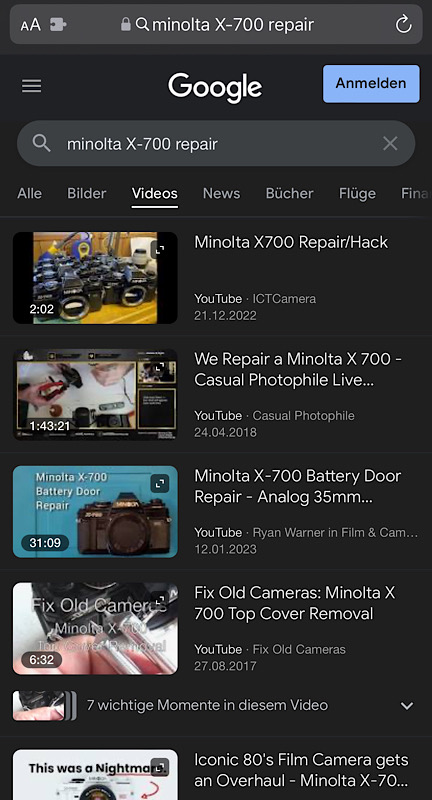

How do I start?
It's best to do first a short meditation on the training device.
How does the device work, what doesn't work, what could be the cause of it, do I have to open the device to find the error, could it also be a simple - and therefore one of the most common - cause?
This is where research on the Internet begins.
The chances that a photo device with the same error will be discussed in an article or video are good.
If you can't find anything about it, you're not only a flight captain, but also an investigator 😉
My first step would be to go to the repair forum here to ask questions.
If it stays quiet there, you go on a journey of discovery yourself.

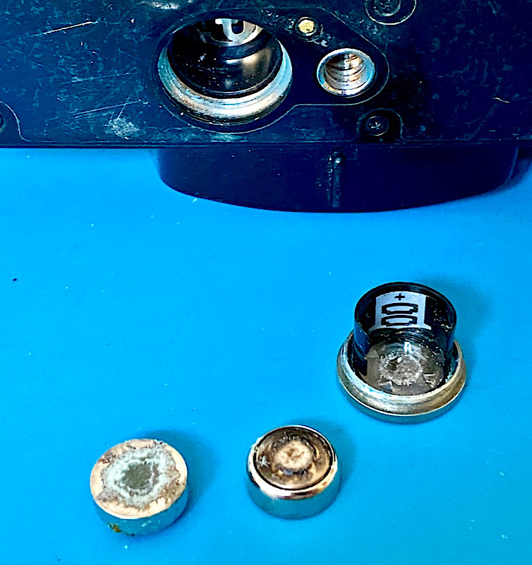

  • Exhausted batteries that no longer provide enough voltage for the device. It then doesn't work at all or shows unusual behavior.
  • Oxidized contacts in the battery compartment and on battery holders. Even very thin coatings can inhibit the flow of current or interrupt it completely.
  • Battery contacts corroded by battery acid, which unfortunately often occurs when batteries are forgotten in the device. The batteries leak and the battery acid eats away at the metal contacts over time and can also spread further into the interior of the device. Damage to the electronics is possible.
The best thing to do is to remove any oxidation from the contacts and then insert new batteries.
For cleaning contacts electronics cleaner on a cleaning stick is a good option for this. Or an eraser.
Corroded contacts are more difficult to treat because intensive cleaning is necessary to completely remove the battery acid residue.
For a way to clean corroded contacts (as an example of an extreme case) see

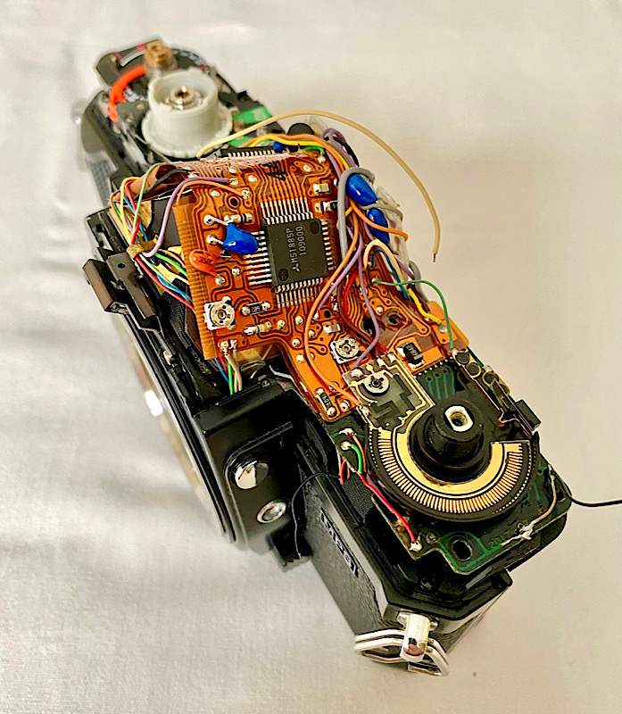

The mechanics, the electronics or both?
Once the power supply has been checked, you should check whether the problem could be mechanical, electronic or both.
This is no longer that easy, as it requires experience and the device usually has to be opened to check.
A component in the mechanics can jam or break (e.g. plastic gears after long use).
There can be contact problems with the electronics, often caused by oxidation, corrosion, moisture or dirt. Electronic components can also fail, but this is not the rule.
Photo devices in general - with the exception of flash units and motors - are low-power consumers, electronic components do not heat up to a great extent, which could be stressed or overloaded over time.

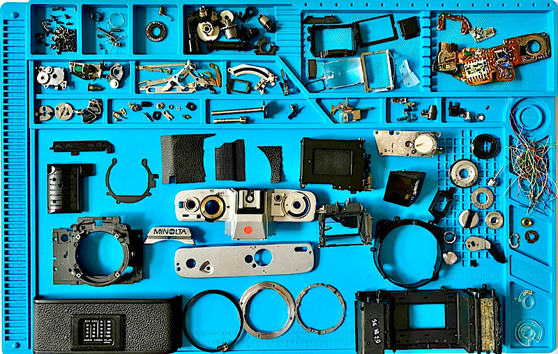

Insights and spare parts
But you don't always have to go on a fault hunt.
Just opening a camera, disassembling it and studying the technology is interesting and provides insights.
If you do it properly and don't damage anything, the dissected camera remains as a prepared spare parts supplier.
