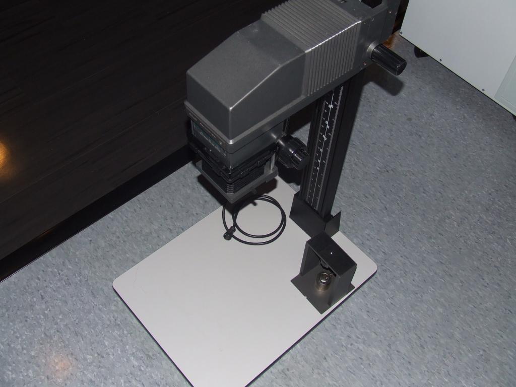

As the title states, I am contemplating fixing up a Phillips PCS-150 that I don't have use for. I have been contacted by a new member in Rome, Italy that might be interested in paying the shipping costs. Certainly many factors could prevent this from happening, but I'll start documenting things here for the interest and possible educational value of the endeavor.

My personal impressions of the enlarger's design and construction are as follows:
The overall build quality is top notch. Some of the USA enlargers are a little crude in comparison. The design is very elegant and sturdy.
The focus control has a concentric fine-focus ring that is smooth to use.
The lensboard is a quality casting that is machined with Leica threads.
The entire enlarger is cast aluminum.
The head comes off the column easily and a copy mount can be fitted.
The head rotates 90 degrees (but there is no formal perspective control).
