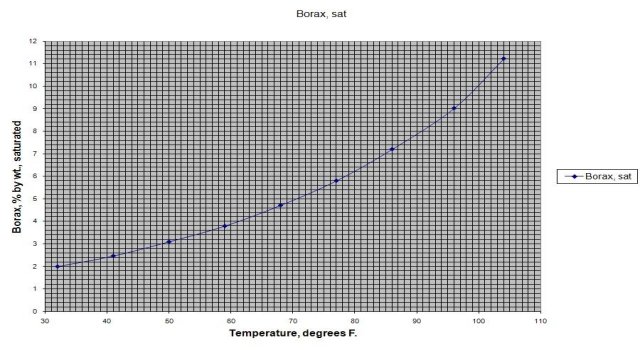

Saturated borax solutions
This chart of saturated borax vs temperature should be of help if I can get it to come through.
