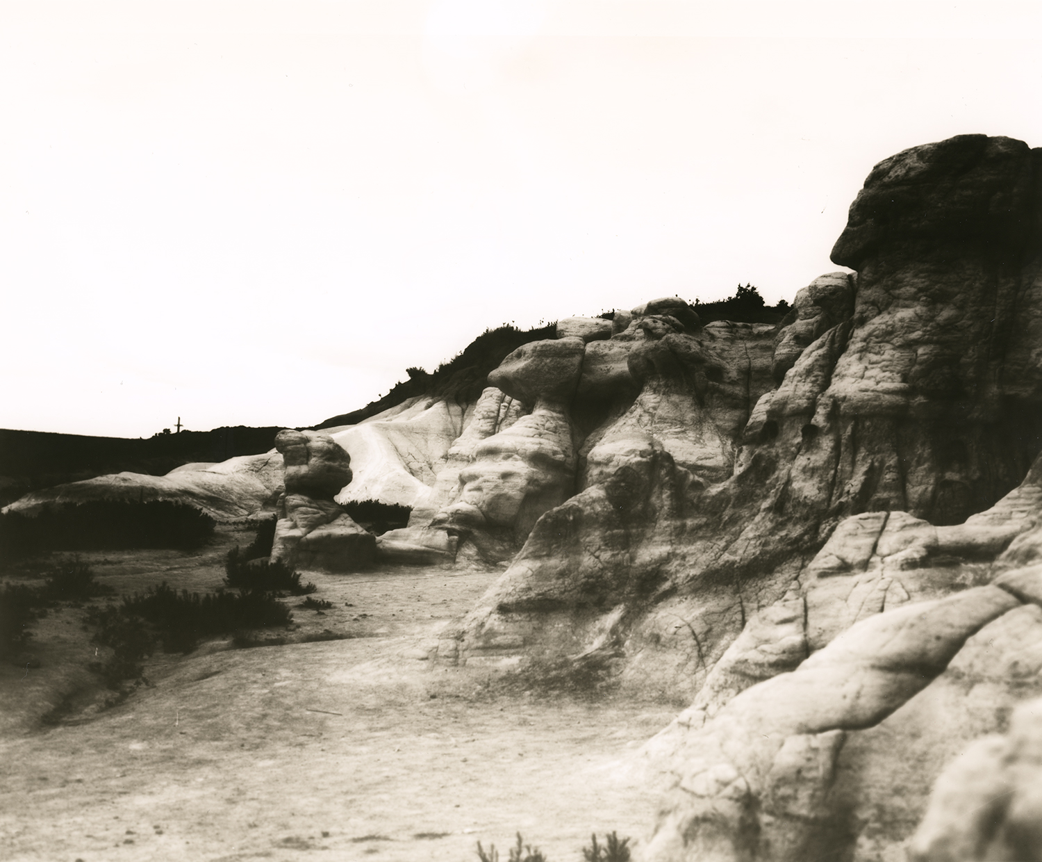

“EXF1G” partial gold toned

“EXF1D” (before toning), Ilford Cooltone RC in Pharoh Lith from 645 ortho litho negative

“EXF1G” (before toning), MGV RC in Pharoh Lith, printed from 645 ortho litho negative

Fomatone 133 FB in Pharoh Lith from 645 ortho litho negative, strong oxalic acid “bleached”

“EXF1D” partial selenium toned
