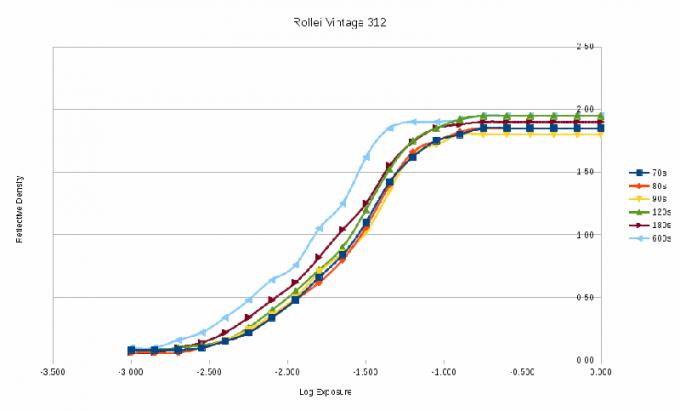

Time for experiments then. The attached image (source data is in the attached ods file) shows the density over exposure curves for a transparent step wedge (Stouffer TP 4x5) contact printed onto Rollei Vintage 312 paper (IIRC that's some Foma paper). The different curves show the effect of different amounts of time the paper spent in the developer (some crazy concoction of mine, who cares). There is a visible difference between 2 minutes development or less, 3 minutes and 10 minutes, but it's more in terms of effective paper sensitivity than tonality. One could argue that dev times below three minutes give a slighty convex curve, whereas 3 minutes and above give a straight curve. If you want reproducible image brightness, keep your dev times consistent, but beyond that overdevelopment is not nearly as scary as it sounds.
Development times of 60 seconds and below gave uneven results, therefore the curves start at 70s. I know from sulfur toning, that Foma paper doesn't like incomplete processing, and that Ilford MGIV is more tolerant in that regime. I would dare a guess, that schlger used standard dev times, and didn't account for the fact that Ansco 130 is quite a bit slower in action than commercial PQ developers.
