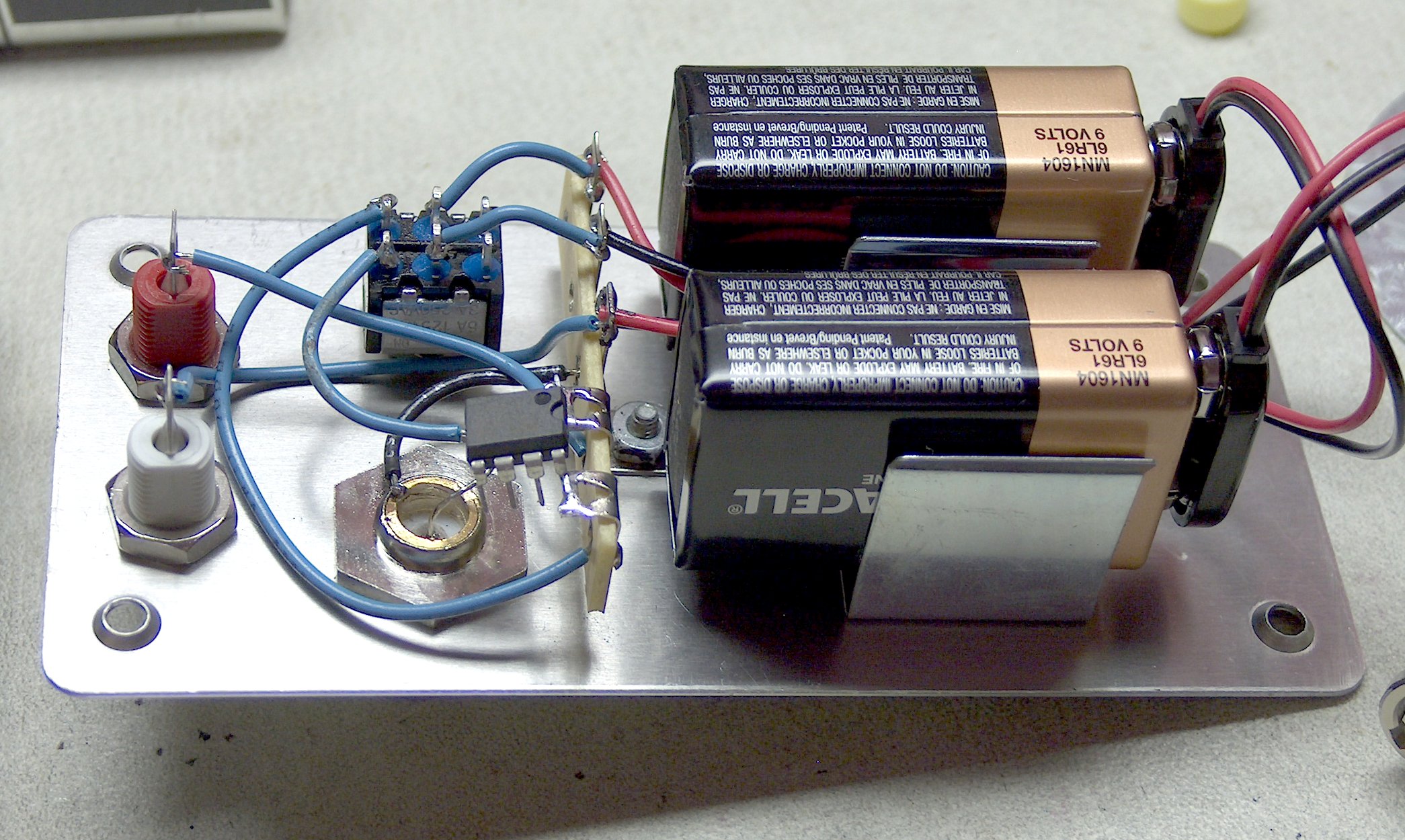

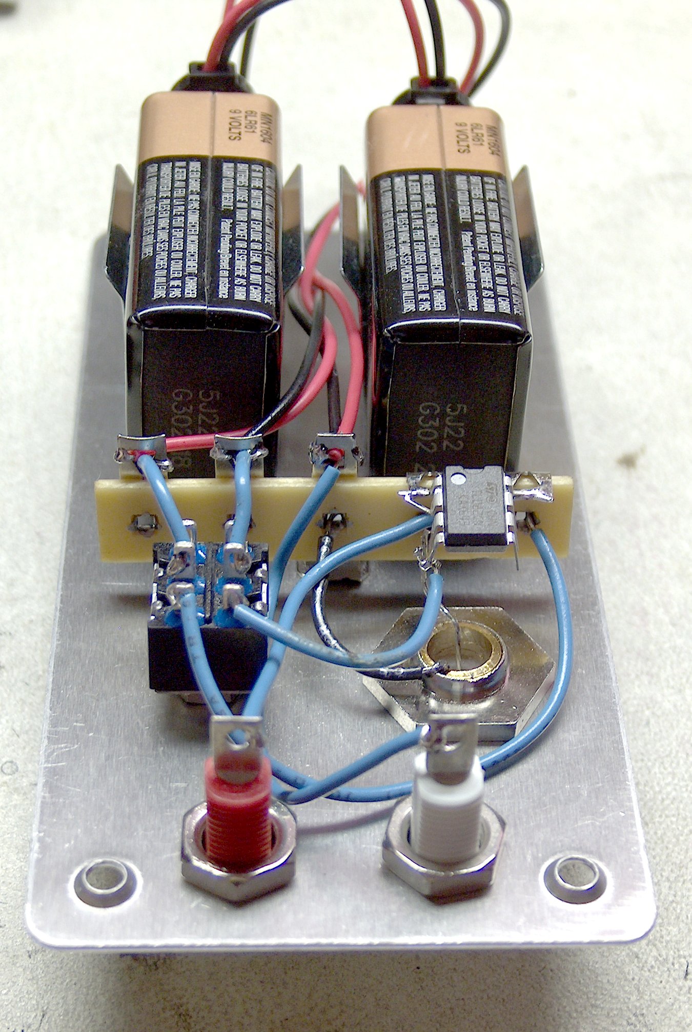

The cheap Hanna meter broke! I wanted to be able to run experiments this weekend, so I built my own based on this web site that describes a simple DIY meter. Its heart is a TL082 op amp. After spending a few USDs at Radio Shack, I built this (inside view):

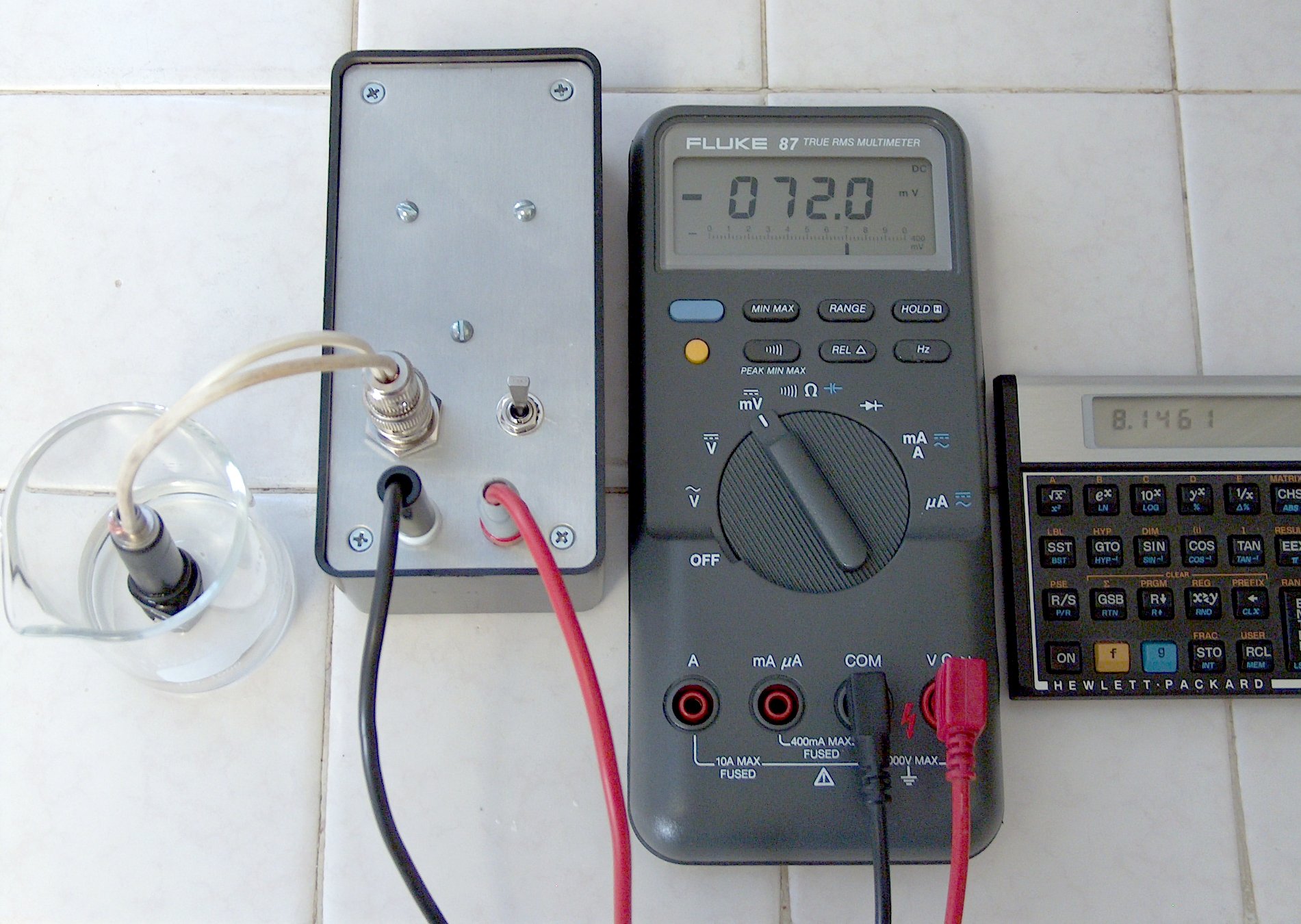

Here it is taking a measurement of a developer. Connect a voltmeter to it, and then calculate pH based on millivolts.
You calibrate it any way you'd like, which gives you a slope and offset. Having those, the actual pH calculations are quick; much quicker than the time it takes to measure and mix the chemicals and wait for the probe to settle.
