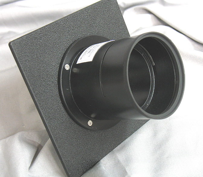

May I suggest taking a look at something even more primitive than a Petzval lens.
Go back to photography's first lens designed as designed by Willaim Wollaston in 1812.
Read about it here...
and here...
www.Re-inventedPhotoEquip.com
They're compact and cover 8x10 easily.
Here are a few examples:
Reinhold
