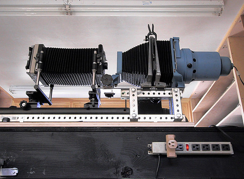

Another possibility -- capture your scan with perspective control in the first place. This is entirely possible if you happen to have a BetterLight scanback attached to a view camera together with a Schneider Makro 120 lens. I have built such a device which you can see here:
With the proper lens tilts you can achieve perfect scheimpflg -- obviating the need to stretch things digitally. Of course, nothing could be easier than clicking a button... :wink:
