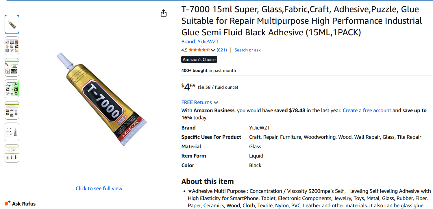

I've used this glue for bellows which is black, flexible, and has an applicator like a needle:
If the issue is the inner and outer layer separating you might be able to make a tiny hole in the outer layer, squeeze some glue in and clamp it with magnets or something until it dries. Then you could repair the small hole you made with the same glue.
I've personally only ever worked on the outside layer of bellows though.
