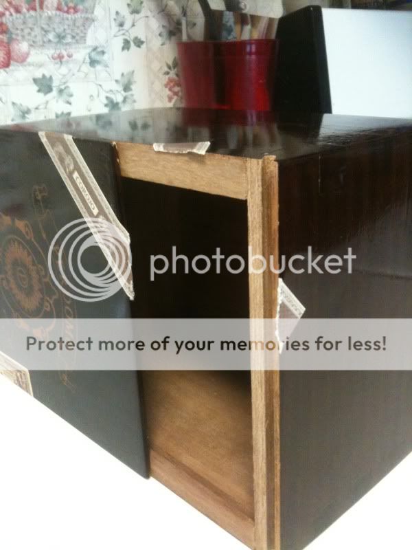

I have been toying with the idea of making a cigar box pin hole camera. The box I have has a sliding lid and is made with !/2" thick red wood. The inside dimensions are 4 3/4"W x 6 1/16L x 3 3/4D. The lid has dado cuts that slide into matching dado's in the top of the box with a half inch overlap on the ends and sides. It is a fairly hefty box with finger joints and as I said, I had played with the idea of a simple pin hole but I can never do anything the simple way, I always find someway to complicate things. What are your ideas on a 4x5 GG with the same in a cut film holder for this project? The way I see it, the GG can simply slide into the dado for the top for viewing and be replaced by the film holder with the film at the same distance from the "lens/hole. Remember, the film will be 3 3/4" away from the lens/hole. Ok, ahy ideas.

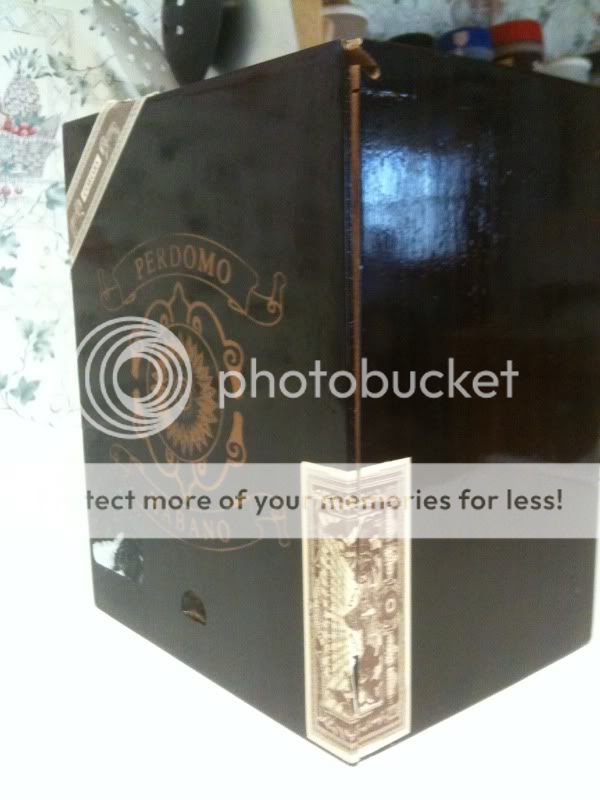

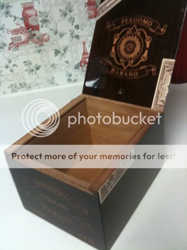

A few pictures:
Any ideas would be appreciated. Thanks

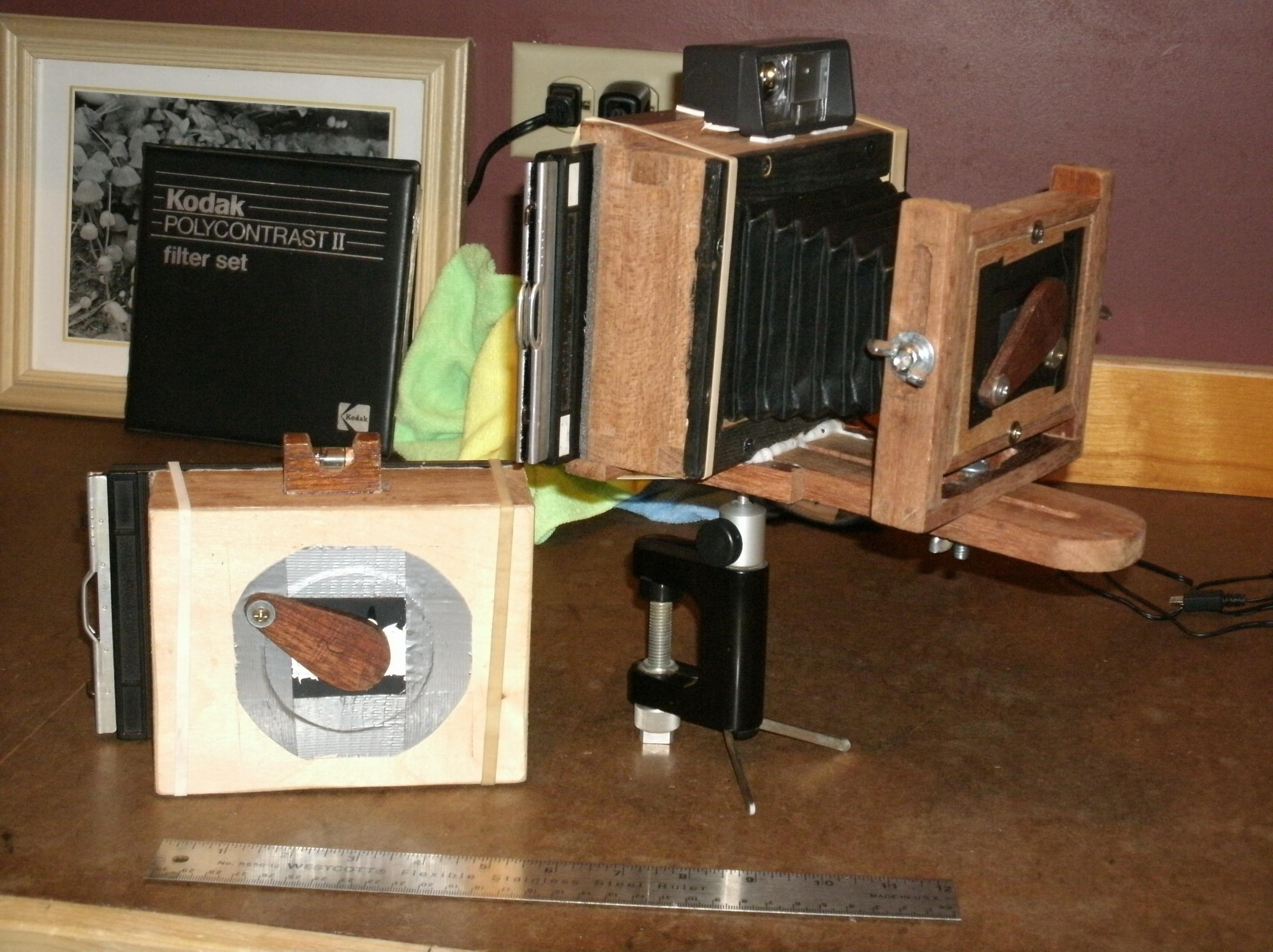

Acording to the dimensions you supplied, should be able to make a 4x5 out of it, using a 4x5 cut film holder. Its all up to your imagination. Both of these use 4x5 film holders, the bellows camera has a GG and I can put lenses on it, the fixed length is strictly pinhole.

I like those. Is that a Polaroid viewfinder/flash on the bellows?

Its only the view finder sans flash and Polaroid bellows from a model 210. I have a couple of different lenses plus the pinhole for it. The VF gives rough aim, I made a gound glass for focusing through a lens.
