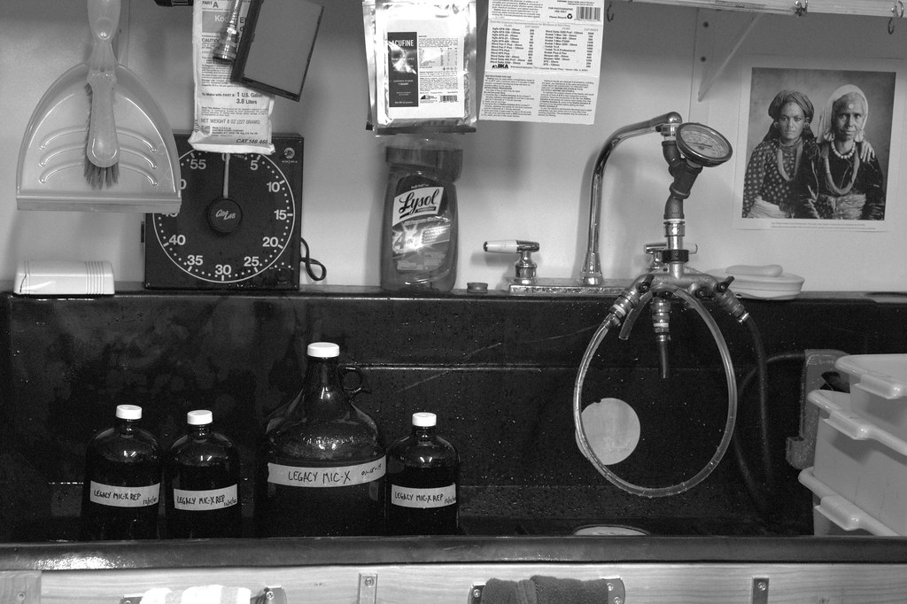

Nokton48
Oct 8, 2006
2,961
My Mic-X Replenisher Scheme by Nokton48, on Flickr
Gallon of Legacy Mic-X from Freestyle, Gallon glass bottle from Photographer's Formulary. Mic-X Replenisher in 950ml bottles also PF. I mixed this stuff back in 2019 and it's still good! Although it needs to be filtered, I bought a box of lab filter paper in funnel. This is a SSSLLLLLOOOWWW developer I have gone as far as thirty minutes, it's hard to overdevelop to the point of ruining anything with cold olde Mic-X.
Looks good, thank you for posting this.
