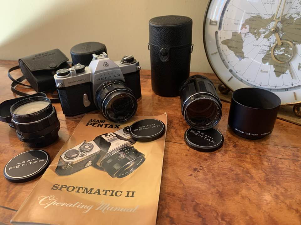

I have a Pentax Spotmatic SPII and 3 lenses. I was thinking of using the M42 lens on a digital camera.
Any experience with this matchup? Which adaptor too?
Thanks
