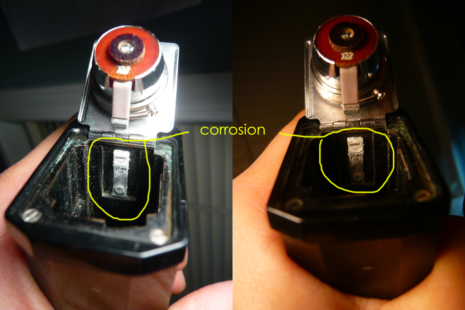

opened the bottom and the terminal is corroded - see picture plz
how should i clean it
i read to use white vengar and a qtip, and then rubbing alcohol and a qtip
should i return it instead - it was rated at EX condition - returning would be a hassle because i live in canada and would have to drive down to the states twice to the post office - once to fill out a form that would let me use that post office to receive a letter from keh if they agree to mail me a shipping sticker to pay for the return shipping, and then once more to pick up that sticker and slap it on my return box - maybe they would mail me a shipping sticker to my canadian address, maybe

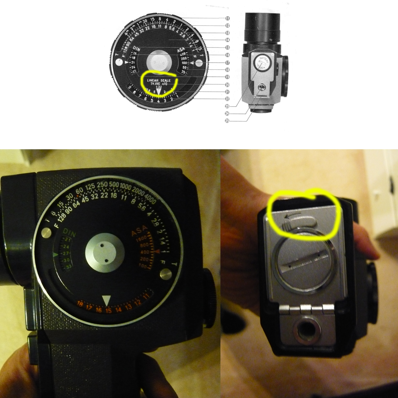

also it looks different than the pictures in the manual i downloaded - see pictures plz
the EV dial only goes from 3-18
there's this extra thing on the bottom that lets me open up the handle - that's how i accessed the corroded terminal
there's no scale illuminating button
the light level meter has the high/low thing - that's from older models i think - is this even a V?

Why can't you just post it? Does it work despite the corrosion or with enough cleaned to make contact? If so I think I would just clean it up and keep it.
Steve.
Corrosion marks are usually not hard to clean. I revived this way a Metz CT-1 which I received from one of those dubious auctions on eBay, described as an heritage, as-is. After cleaning (just using a "brillo" pad with some alcohol IIRC) the flash was as new. It also happened on some other couple of occasions with something at home.
I have often read that corrosion on the contacts can damage the electronic components inside, but never experienced that.
I would write to the seller showing the pictures with the corrosion, and suggest I would try to clean the contacts by myself, but if that is not cure to the problem, I would send it back. Sending the photographs first is important so that they realise that the description was not correct.

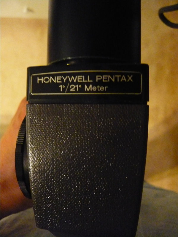

I own a Pentax V. The Pentax 1/21 and the Pentax V are different meters. KEH appears to have picked and sent you the incorrect meter from its warehouse.
Here is the full user manual for the 1/21.
(It's a 7.85 MB document.)

looking at the invoice, it looks like i actually bought a 1/21
not sure how that happened since i was looking for a pentax v
Corrosion on battery contacts cannot harm components inside but it could be a sign of further corrosion inside which might have caused damage.
