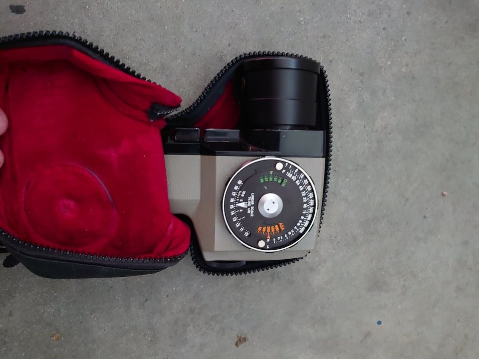

There is one of these available for sale locally and Im wondering if I should grab it? Does this meter take several spot meter points and average them out? Or does it only take one reading? Im wondering if its like the Sekonic spot meter in their units?

Its the old meter from well over 35+ years ago. Here is a pic. It looks like the Spotmeter V. I have used this meter once back in late 80s, but its been so long, I forget how it works. In the viewfinder, it showed a meter with numbers 0-13 or so. I dont remember how those numbers correlate to a number you can use for your camera? Im guessing you use the number on the meter inside and move the outside dial to get your reading on the above scale?

Looking at it now, it looks like it will only take 1 reading. Not an ideal way to get a reading.
It does all you need a spotmeter to do in order to get a useful meter reading. More importantly, It has the IRE scale which will do a better job of indexing your exposure than any of the silly zone dials or time-wasting multi-spot tea-making functions. Personally, I'd go for a Pentax digital spot meter in preference - mainly because it doesn't rely on electro-mechanics.

Both the Pentax analog and digital spot meter commands high price because... It takes exactly 1 reading that is the LV value (which is EV number for ISO 100). That's all. The rest is done with the purely mechanical dial. Check the Minolta Spot meter M which is less expensive than the Petax today (was significantly more expensive in its day) would do that averaging and also read to 1/10 stop like modern meter and not 1/3 like the Pentax.

The Spotmeter V has a nice snap like a microswitch when you take the reading. Unlike the Soligor Spot Sensor which had a home-made trigger that barely maintained contact.. It’s one scale so you don’t have to select high/low range. You can hold the trigger down and “Scan”. That’s something you can’t do with the digital ones.
Depends on how much it costs.
I have one. It works (button is a little flaky,but it works). It is big. Light on the inside does not work, so no light, and this is unfortunate. Right now it is my only spotmeter (had a Minolta M, but it failed). I must asmit I do not use it a lot because I do more "walking around" and travelling photography, and it is kind of bulky for either.

People always complain about the light… did you know it only lights up the first few numbers? You can only see it in the dark for the only numbers you need light to see
Mine is an old one, mercury battery old, and it did a good job lighting up the whole dial -- until I installed an adapter for a lithium button cell; the regulator won't pass enough current to light the dial lamp. OTOH, I don't have to deal with zinc-air hearing aid cells dying in a few months whether I use the meter or not, or pay for Wein cells -- the little lithium button cells aren't free, but they last a long LONG time, and the adapter ought to last longer than I will.
I suppose if I were going to do a lot of low-light work with it, I could carry a packet of hearing aid cells for when I need the light -- or get it converted with an internal regulator to use silver oxide. But since I almost exclusively use Fomapan/.EDU Ultra, which has the worst reciprocity on the market, seeing the dial in the dark isn't a high priority.
