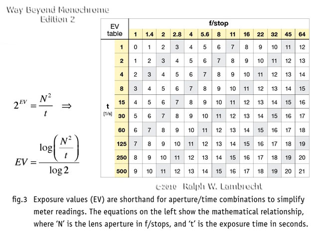

The readout inside the viewfinder should be EV number for ISO100. So if you read a gray card under sunny 16 lighting condition it should read right around 14 and 2/3. If this is true then the meter has not been recalibrated electronically and you're good. Now if you can post a picture of the dial I think I can decipher it.
Please note, EV numbers simply specify a shutter/aperture combination and are independent of film speed (see attachment).
However, the sunny-16 suggestion for ISO 125/22 is a good one, because EV-15 is the combination of f/16 at 1/125s, and that is the Zone-V exposure for a film of at that speed in bright sunlight.

If EV is what you say it is, then what do the 1-19 numbers mean in the Pentax V? Since it's uncoupled, are they just arbitrary values?
So, by using published data/common knowledge, how should I do the proper markings on the shutter speed plate? I guess, if you just told me what SS resulted from #4 on the value dial @ ISO 100, f/5.6 (for example), then I could do the rest just by using the law of reciprocity.

...I guess, if you just told me what SS resulted from #4 on the value dial @ ISO 100, f/5.6 (for example), then I could do the rest just by using the law of reciprocity.
On my meter the following lines up exactly:
ISO 100
Time 30
f/stop 32
EV 15
