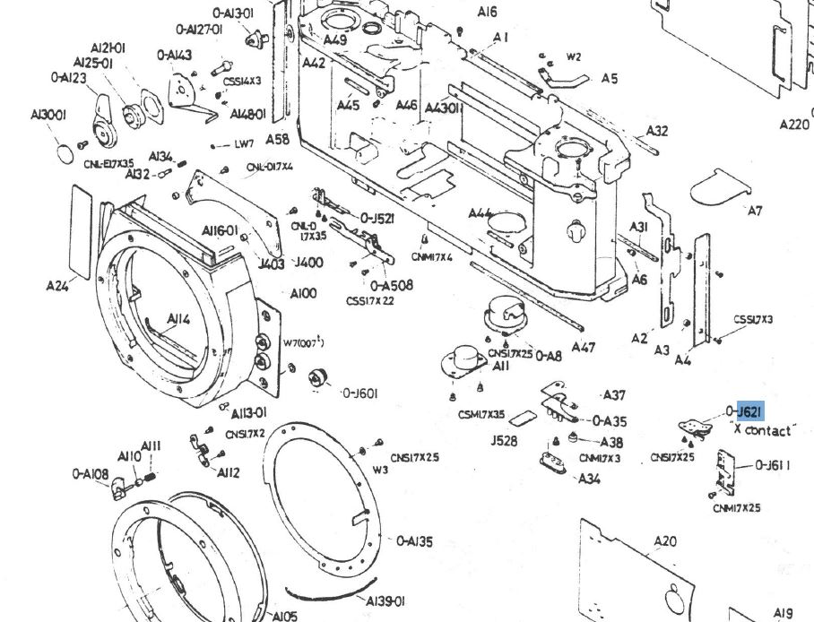

Does anybody know the actual location of Pentax MX X-Sync switch?
P/N 0-J621 from the exploded diagram it looks like facing down on the bottom?
But there's nothing that looks like it on the bottom
But there is this switch on the front
The switch on the front looks exactly like the replacement parts sold on auction site :

It should be closing about the time the first curtain reaches the end of its travel, if that helps.

Yeah, that's it. It is triggered by the opening curtain wind gear, which sits directly above it. The wind gear spins as the opening curtain travels and when it reaches the end, a post closes the X-sync switch.
They just didn't have enough room to put it close to its installed location in the exploded diagram. There might be some dashed lines that didn't make it through the scanning process.

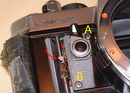

Someone else's photo here but these are the two screws, correct? And the access cover is removed.

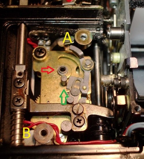

This is also pic from someone else which shows the four washers that you mentioned on A & B.
My question : is the lever screwed to the hole pointed by red arrow? If the lever is screwed to the hole it means that I have to unscrew the self timer lever to remove the front plate, no?
The post on green arrow seems to activate the self timer.
Correct.
No, it doesn't screw into that hole. The lever mechanism just pushes on the post indicated by the green arrow. It will simply lift away from it.
