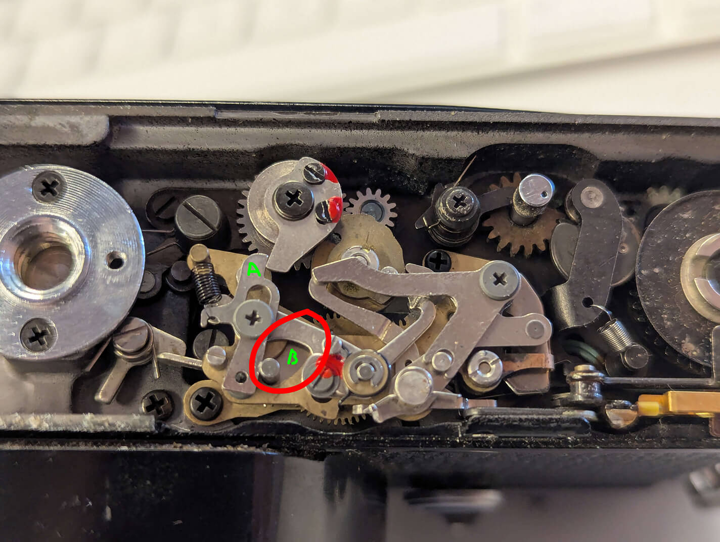

I'm looking for some CLA advice for a Pentax MX I've picked up.
The shutter is sticking on slower speeds 1/30th - B and doesn't budge at all, keeping the curtain open and the mirror up only when turned to a speed over 1/30th and re-cocked the shutter closes and the mirror drops down.
I've taken the bottom off to have a look and from I can see the slow shutter assembly seems to be jammed and is holding the shutter open.
I've attached a photo, part B which I've marked I'm guessing adds some resistance to part A to get the desired shutter speed.

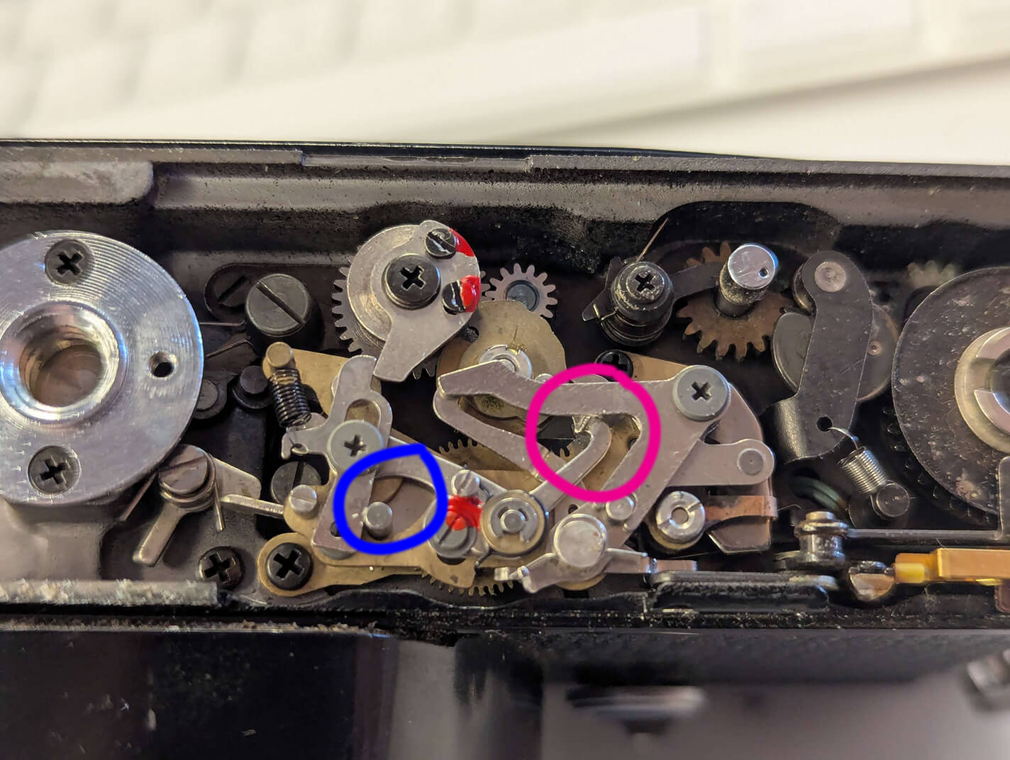

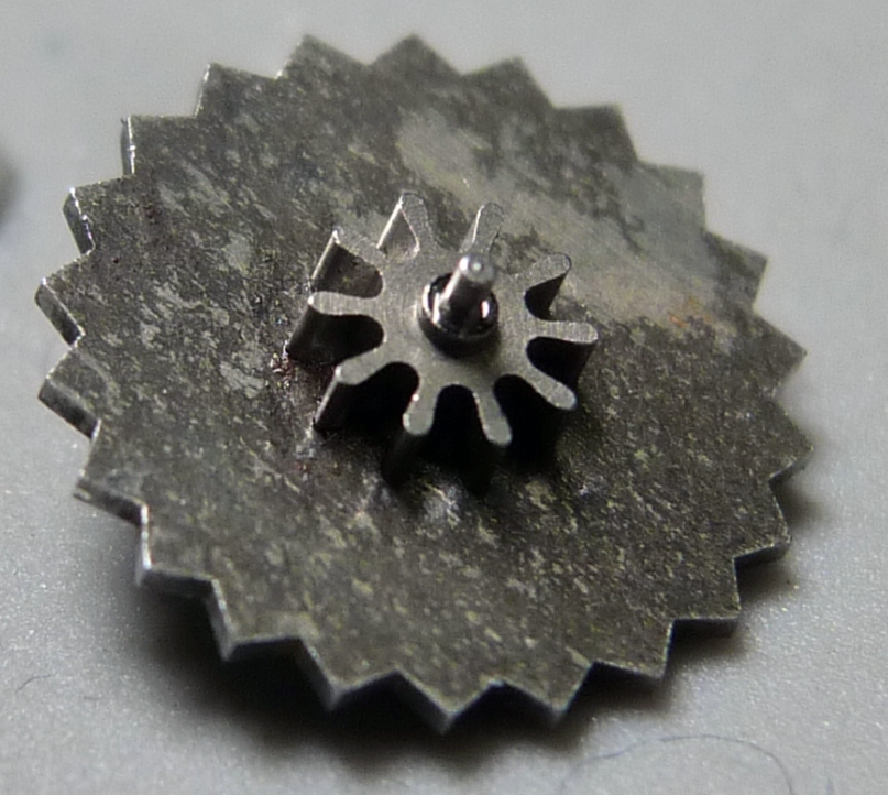

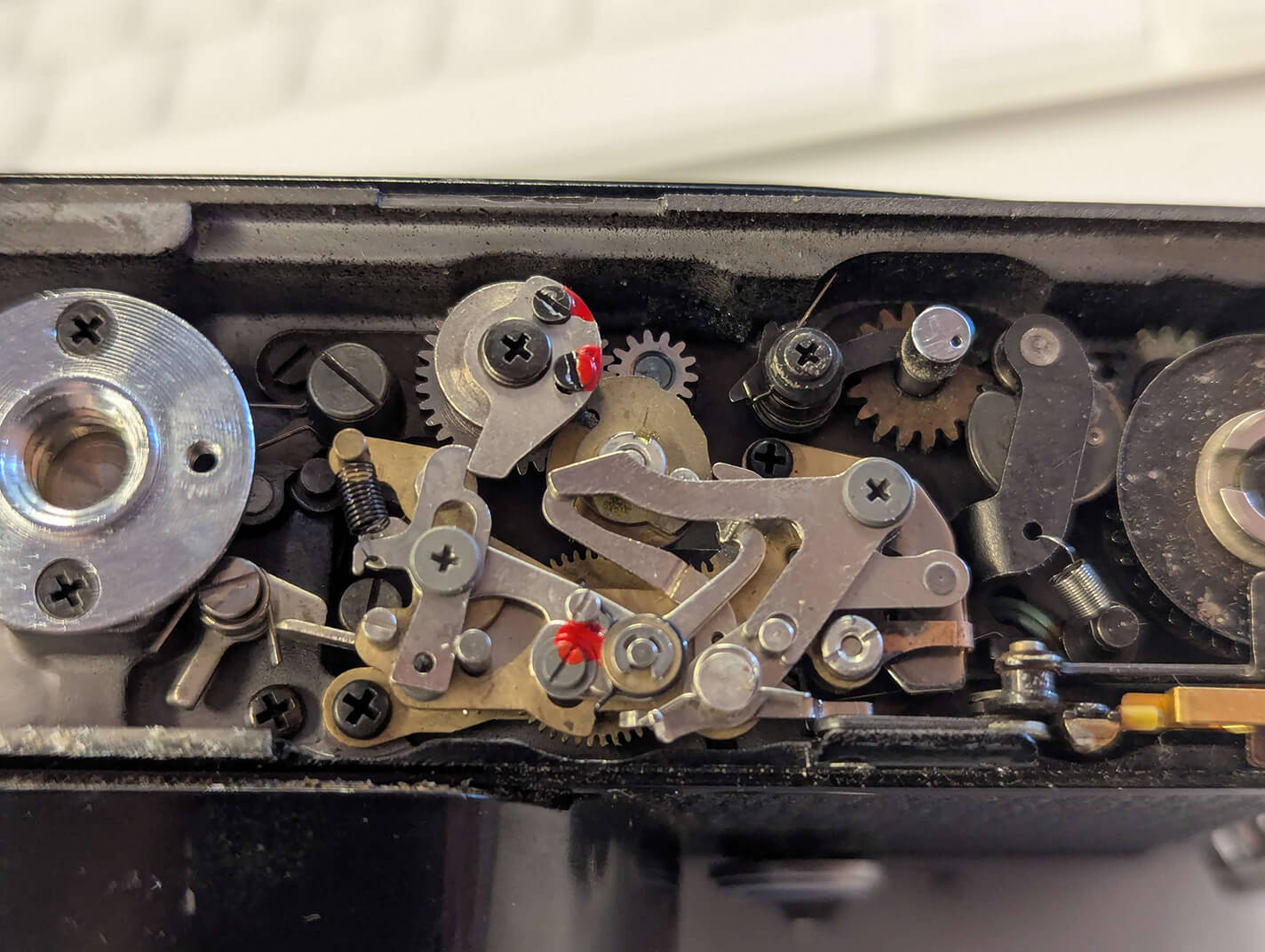

Thanks for your suggestions, I managed to get it running. I was a bit concerned about how seized up everything was and wanted to get things moving slightly before going in with the lighter fluid to clean off the old grease.
I've attached photos, using a wooden toothpick I located the escapement wheel (see example silver with triangle teeth) sandwiched in the slow mechanism located roughly where the magenta circle is in the photo, this freed everything up to where I could move the pin in blue and apply lighter fluid to clear it all out. I then applied small amounts of sewing machine oil at the pivot points. Cheers George
