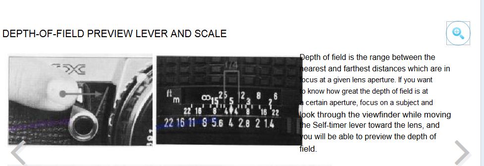

This is going to sound slightly crazy perhaps, a longshot at best.
I want to MODIFY my MX to have a DoF preview.
I may in the near future have access to metal parts fabrication and other associated tooling. I have a bum camera body (also an MX) which can be used to test any prototype design I come up with, but I am limited in understanding on what mechanisms are involved in triggering the diaphragm to close independent of the shutter, having access to only the service manual for the MX. Has anyone ever had such a crazy thought? Any insight and advice is welcome, I hereby place my idea on the table for all to offer their $0.02

I will check my Pentax MX, but I am very sure it already has a DoF preview by pushing the self timer towards the lens.

Well then. That simplifies things. In all the material I've read on the body I can't recall ever seeing that. I thought it was an innovation that was added to the LX after the MX's production run had ended.

I'm ignorant on the MX. What is the idea of the self-timer lever actuating also the automatic diaphragm. It does not hurt, but I do not see the benefit or a technical reason.

From the MX manual:
It saves having a separate lever on the camera--less manufacturing cost. Has nothing to do with a benefit to the photographer or any technical reason.
Innovation? Older cameras are more likely to have DOF preview than newer ones. Not an innovation but a necessity on some older cameras that can only meter stopped down. Worse some require you have to manually stop the lens down before you take the shot.

I think it's brilliant. Right where I would want the DOF preview lever to be.
