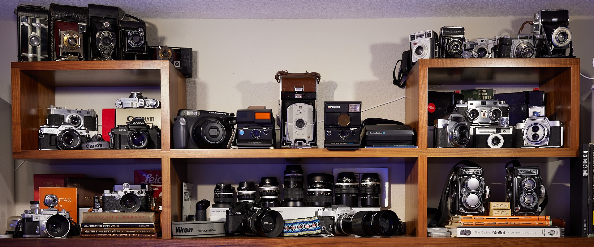

I have a small camera collection that was started with cameras my Father saved for me over the years. Since then family friends, childhood friends, and camera club members donate cameras. I just received two Pentax Cameras, a ME and a K-1000. I was not impressed with the K-1000 but love the size and weight of the ME. I am waiting on batteries but am already considering a ME Super for Manual mode and higher shutter speeds. I also am thinking of replacing the 50mm F1.7 with maybe the f1.4 b just feels a little to short for comfort. Looking for tips on anything to pay particular attention too and opinions of any kind.

That is a nice display! Someday I'd like to do similar. Now all my cameras are in boxes, closets and drawers.

Beautiful camera collection! My first 35mm camera was a Honeywell Pentax SP 500. I never went beyond Pentax ES, aperture priority, electronic shutter, screw mount Beautiful camera!

Lee Rust

Nice camera collection, well displayed, and it's good to see the Agfa Flexilette in there. I just got one earlier this year. The controls are a bit awkward, but I like the versatile finder.

I like those shelves, did you have them made or were they purchased?
Thanks, we had them custom made and I cropped out the bottom shelf filled with LPs. If my collection gets any bigger I may need to move the albums somewhere else.
