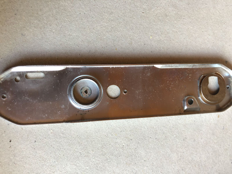

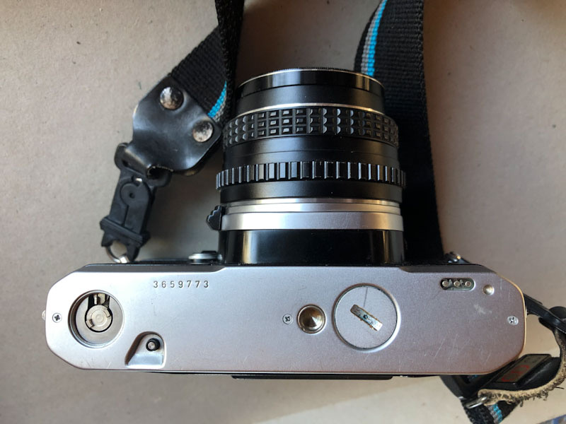

Post some pictures of the camera bottom and both sides of the plate.
This is what it looks like:

Picture 1 - battery and motor drive coupling appear to be different sizes so the caps will not interchange.
Picture 2 - center contact of the battery cover is badly corroded, replace the cap with a correct one even if you have to buy a dead parts body to get it.
Picture 3 - battery chamber and contacts look good.

I’m afraid the previous owner of the camera has used the motordrive cap to replace the batterycap. And now it’s seriously stuck. I’m guessing it’s a combination of the corrotion and the fact that the replacement cap is slightly larger than the original one.
But tomorrow, I’m going to the camera store to pick up some pictures and I’m planning to bring the camera. The owner of the store doesn’t repair cameras himself. But he has a lot of experience with Pentax. So I’m hopeful that he can give me some advice and an estimat on the price of repairs.

Let me help because I know the ME/ME-s/MG/Program-A rather well.
Good news, it has the original battery cover in place. You need to clean out that contact throroughly, don't be afraid to scratch it with a screwdriver or with sandpaper. If the battery cover can't be removed, don't worry, just remove camera bottom whenever you need to replace batteries. They last for a long time.
Now, the batteries are two LR44 (or SR44) and the positive (+) terminal should face the camera. In other words, the battery cap needs to contact the MINUS (-) pole.
If camera doesn't turn on then clean the mating surfaces between the camera bottom and the bottom plate.
