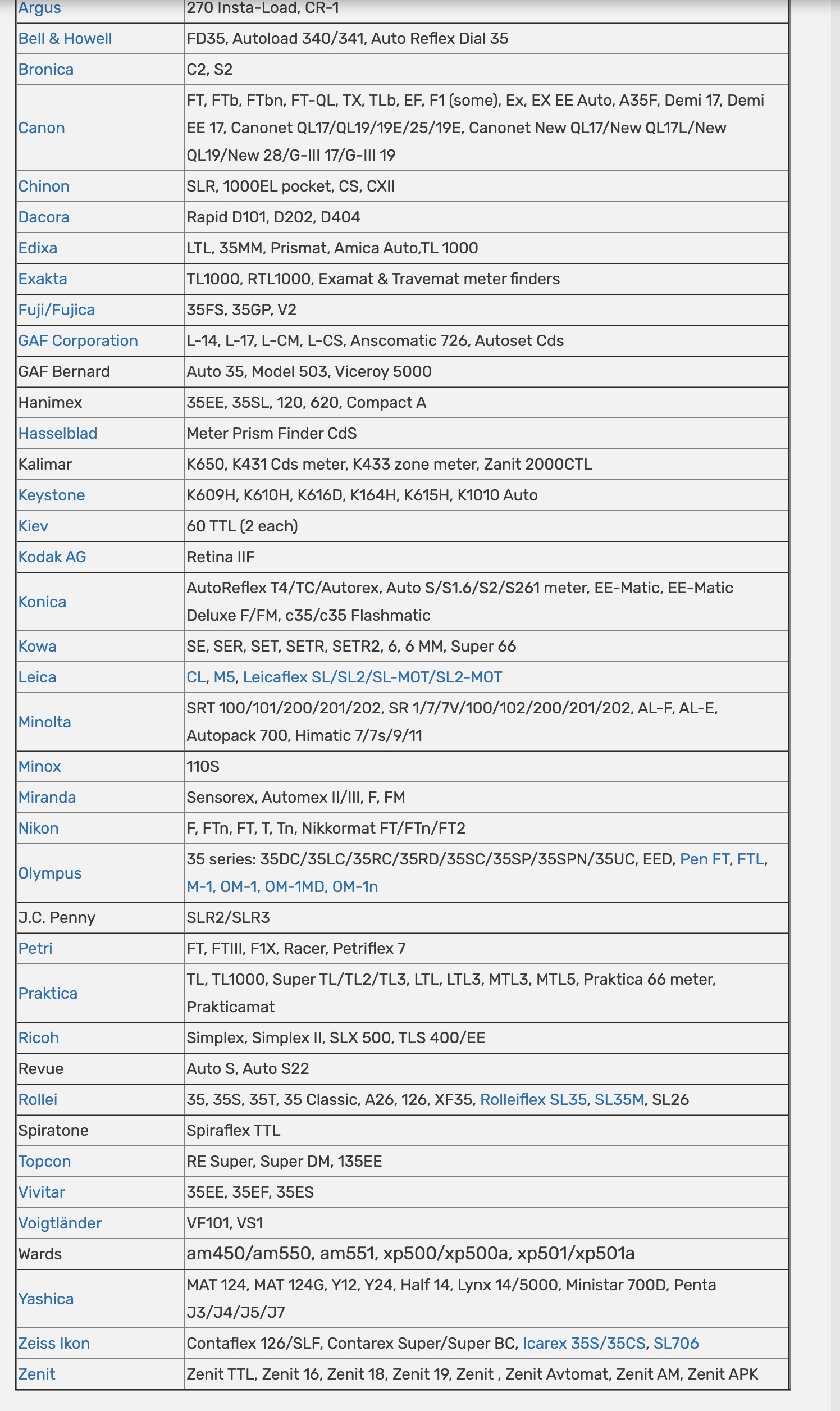

One of my Rollei SL35 came without a battery cap. Those are kind of hard to find. What I did was to locate a referece for battery type. The thought is a camera with the same battery might have a similar cap. Then I scoured Ebay for one of these caps. Eventually one came up for just a few dollars and free shipping.

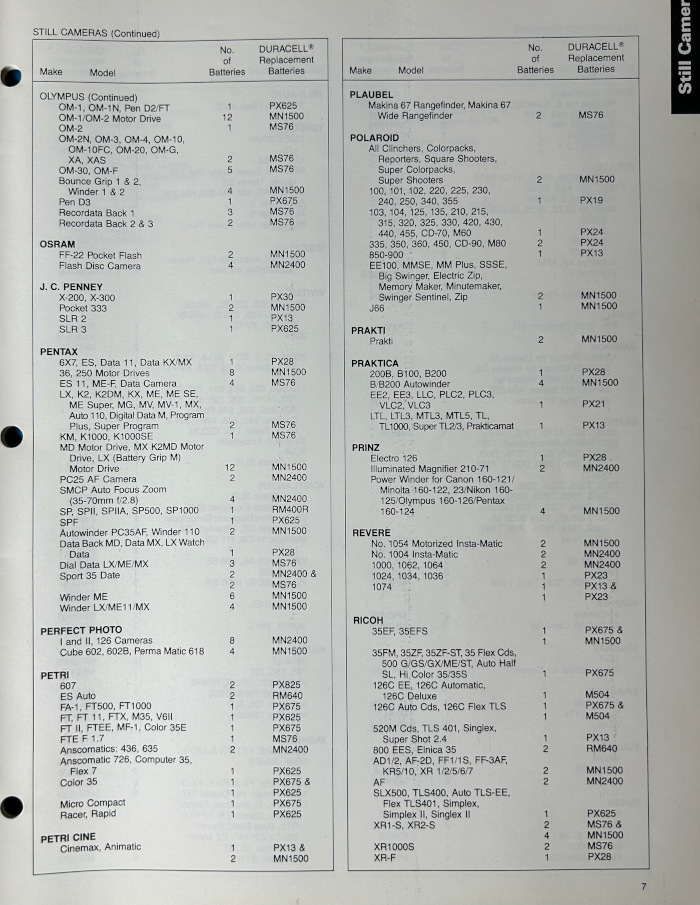

If you are looking for list of battery types for cameras, all the big battery manufacturers put out a cross reference guide to camera/battery type. These are available from time to time on ebay. However, any lists of this type have limited value as there were a number of variables in battery caps: inner build, thread size, cap size and contact type. That is why I had over 200 SKU's of different battery covers at one time. You really need to have each battery cap in hand for an inspection to make sure that it will fit.

Thanks for that info. I'll try to find the source document for saving to my archive of stuff I need to save. :smile:
