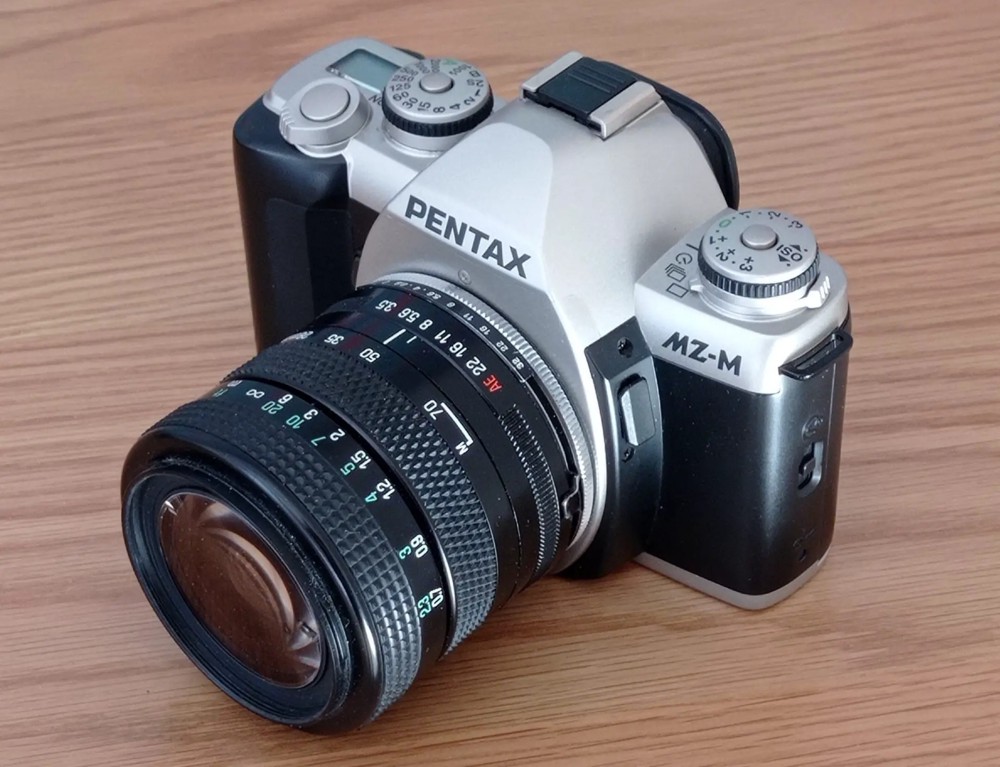

If you want to get away from the original M series, you might try a NON-auto-focus, auto-focus FILM SLR from Pentax. Give me a second.
I don't own one, but I had a chance to use one, and I wish I had one. It's from Pentax's NEWER M sesries -- the MZ line-up.
The MZ is a line-up of auto-focus cameras, but the MZ-X only uses manual focus lenses. Sounds crazy, but there it is!!! Very light, and small, and very nice features. Check it out.
These are much newer, and hopefully have fewer problems. And this model might even be less expensive -- less demand.
