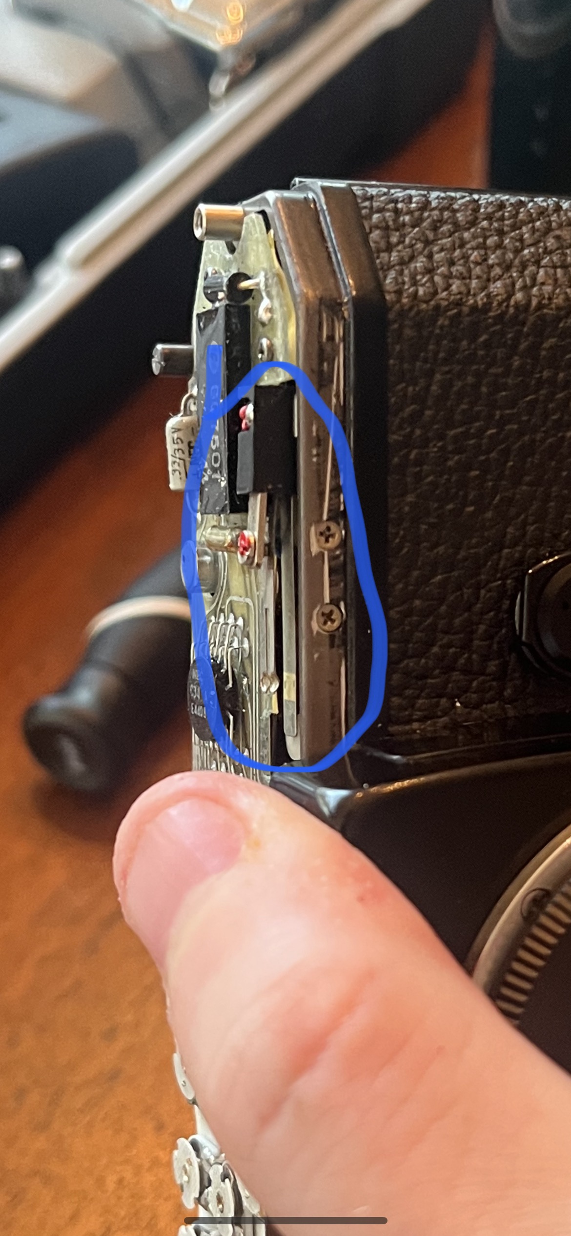

Love to hear it @Pioneer! Hope you had a good day shooting. Not sure if you’re still here @Bill Burk but I see that piece that you’re talking about. It’s very slightly cracked, just enough that it’s raised too much for the lever that the shutter button moves to touch it. Does the crack just need to be epoxied shut? Not sure whether I feel comfortable doing this myself as I’ve never repaired anything in a camera before, but what am I doing here if I’m not learning!
Bill Burk
Feb 9, 2010
9,156
Yes that is the only thing you need to do. If you can rig a way to hold it together while the epoxy hardens you might be able to do the work without even opening further.
May as well play with it as is to see if the shutter is controlled in automatic. Yes you press up on the depth of field preview switch to enable metering with old lenses.
If you can hear it do about a quarter of a second in appropriate lighting, you can be fairly sure the rest of the settings are good.

Thanks bill. When fully pressing the shutter button I am able to make contact/move what I understand to be the lever that triggers the metering reading. And if I hold the lever down slightly to touch the piece that moves when shutter is clicked, I still don’t see a meter reading. Would that mean it isn’t working even if I were to fix or replace that cracked piece?
If so, is purchasing an esii with something like a busted shutter curtain then swapping the main circuit a reasonable thing to do? @John Wiegerink has warned me against working too hard to get it up and running, but I may be interested in toying around with it as a project camera.
I’m still waiting for my first roll to come back using this in manual. I’ll make sure to share with this group when received!

You only get meter readings in Automatic mode, in case it’s just that. The shaft that presses down the flap part of the switch should press it down to the pair of contacts that can be adjusted. If you press those contacts up to touch the flap, the meter should respond. If not, the circuit board is never to blame. It’s more likely one of the 25 wires shorts to ground or something.
I’d aim towards buying a second body in good shape, around forty or fifty dollars. Then you might have both working or one of them is easier to get going.

@Bill Burk My man, we have action! When I switched to auto shutter, and held the flap part down to make contact, I got a reading! Just need to figure out how to get the crack on the black piece closed so I can make contact without my finger.. any epoxy recommendations?

What if I put a lump of tape or something in that inside of the bottom plate, just to compress the plastic piece?
