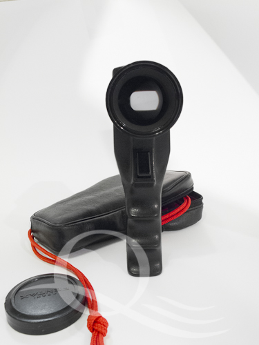

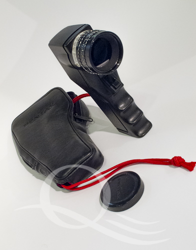

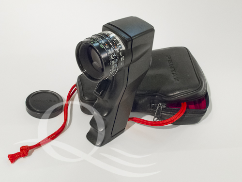

FS – Pentax 1 Degree Digital Spotmeter

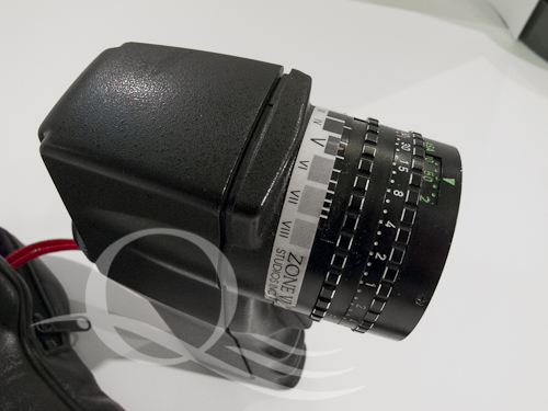

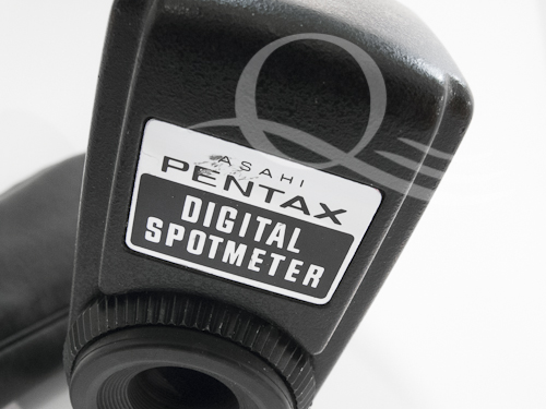

An excellent meter in excellent condition. Fully operational, accurate, with clean glass. Purchased new in 1990 and treated kindly by its one owner (my wife). Some slight abrasions on the Pentax label from the zipper of the leatherette carrying case (see photos). This has the Zone VI zone sticker but is not the “modified version.”
$350. (My normal 10% to the good folks at APUG. )
PayPal or CC. Includes shipping via USPS Priority Mail. US customers only.

And while not modified, it does have the Zone VI zone reference sticker which makes using the zone system of exposure a little quicker.
