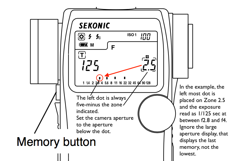

I have the L-758 myself, and a very easy method for Zone metering I have found is to spot meter an area of the scene you want to be zone V, log it into memory, meter the same area again and log it, then average the two (identical) readings. This stored average then allows you to move the spot around the scene with the read button held down and see interactively EV values for everything in the scene, in +/- stops compared to the zone V reading. Very simple.
