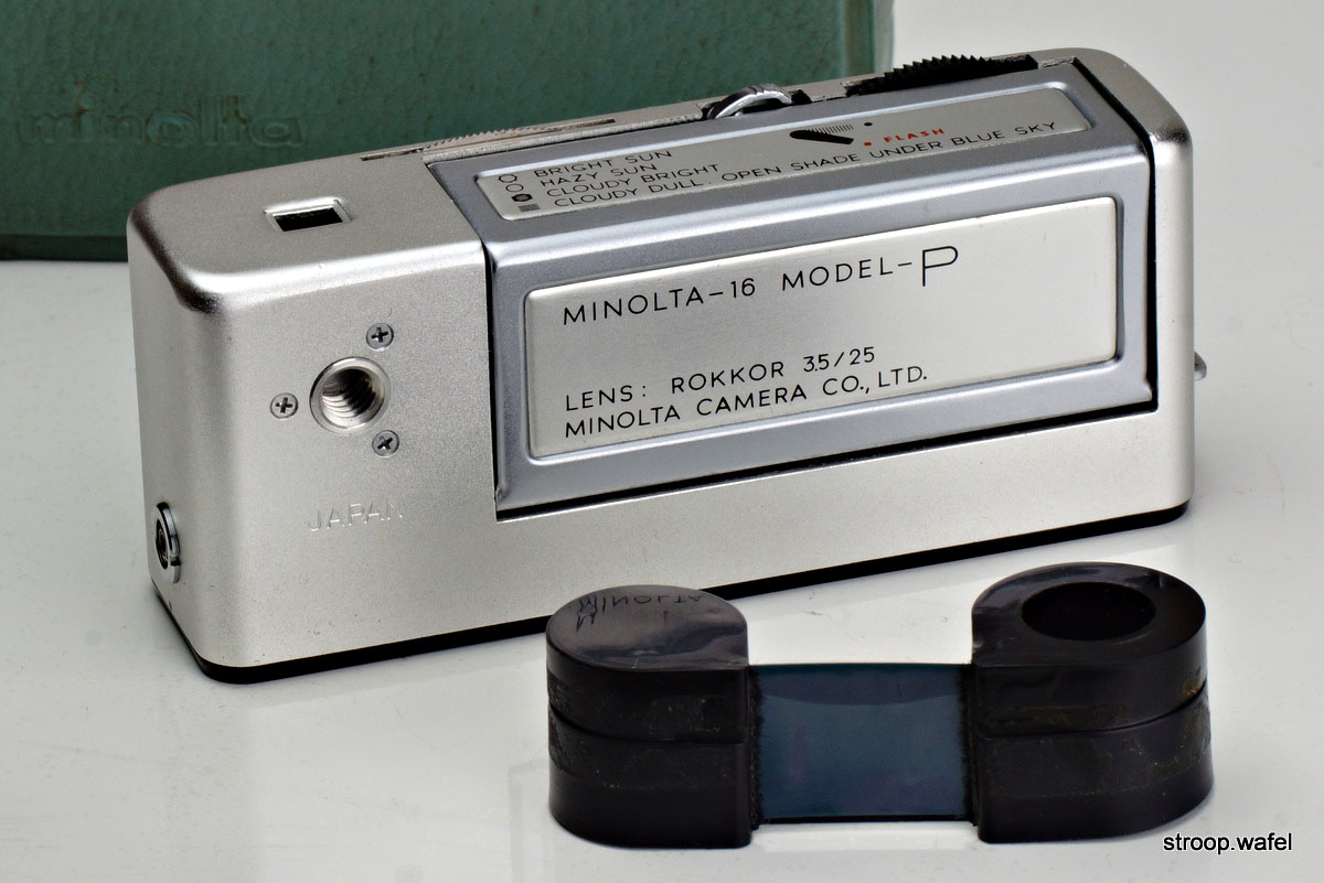

The perforations in movie film will enter the image area of 110 format.
A film splitter can solve the problem.

One reason why I have not gotten into 110 (in spite of the beauty of the Pentax 110). I use 16mm cameras, because, even the lowly 16-P has a proper pressure plate.
