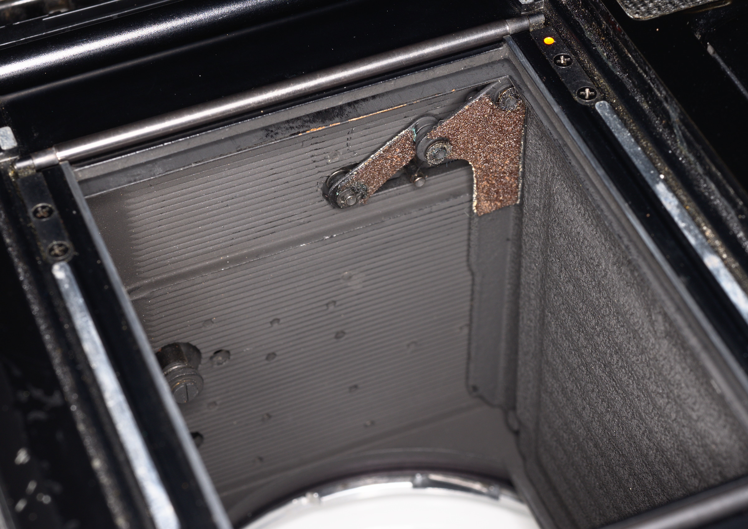

I have a rather old Pentax 6x7 (version without mirror lock-up). I have shot a few rolls with it but the mirror often flips quite slowly and even got stuck half way a couple of times. What I mean by the mirror flipping "slowly" is that it quickly flips half way and then there is some lag before it moves completely up and the shutter is fired. Sometimes up to 1/2 second or something like that. A couple of time the mirror did not flip all the way at all. One time shaking the camera made it finish flipping and the other time I had to press the mirror release button.
I have to add that I have tested with a fresh battery and have the same kind of result. Also, despite the slow mirror, the shutter speeds seem accurate since I have got no surprises on the exposure of the film even when noticing very slow mirror action.

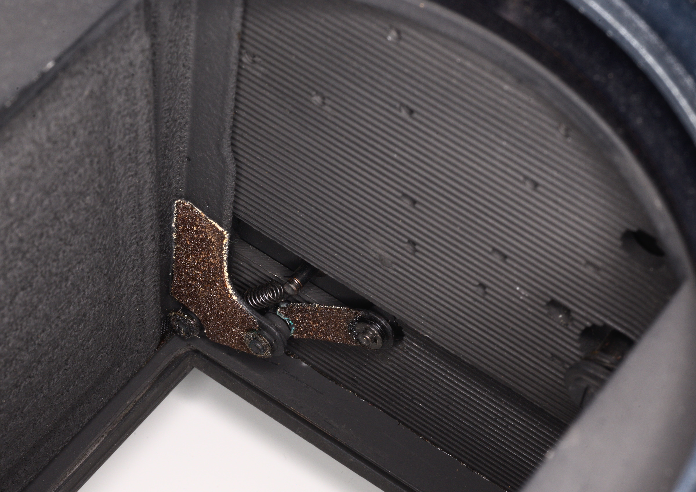

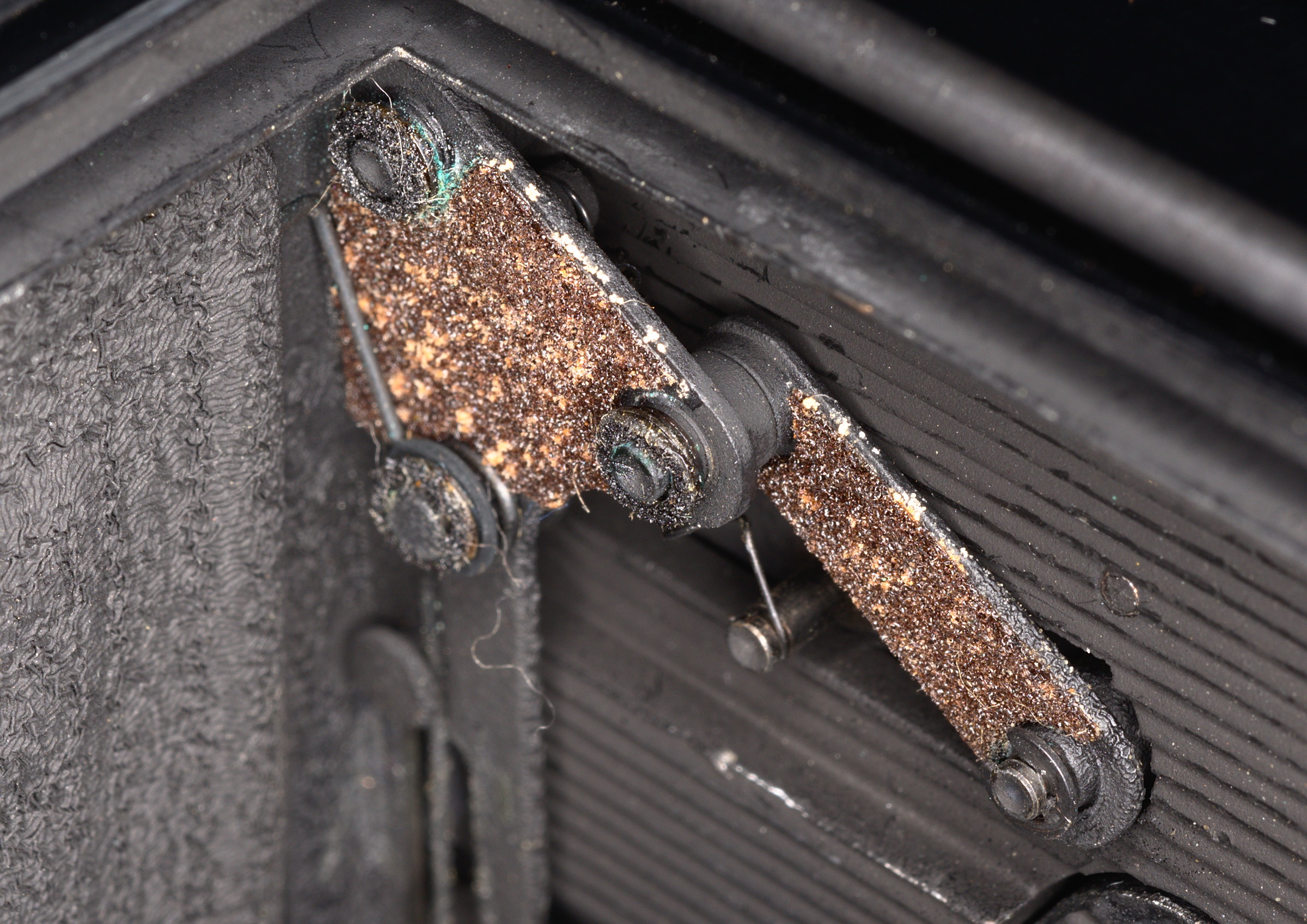

Looking at the mechanism that makes the mirror flip, I am wondering if I could/should do any cleaning and lubrication. Attached are some close-ups pf the mechanism. At first I though that the brownish stuff was rust but it is not, it seems to be some sort of baffling. However, the greenish stuff is much likely copper oxide...
Any idea if it can help to clean/lubricate those visible parts? Is is something worth a try or is it risky?

I think the problem is purely mechanic -- the mirror goes up by purely mechanical means. The shutter speeds are electronically governed, so that's why the timing is fine. BUT, the whole firing cycle is started by an electromagnet. However, i seriously doubt the electrics are at fault. The rust you see is a clear evidence of a mechanical problem.
But in any case the solution seems easy -- apply one drop (or less) of WD40 to those parts and fire the shutter many times. Note... just a very very small amount of WD40, because you don't want it to drop into the shutter curtains.

If "I" were going to take a hand to it, I would use a bit of Naptha (think Ronson lighter fluid, I believe Zippo has changed their formulation) applied sparingly with an eyedropper. Once those bearing surfaces are cleaned, then a tiny bit of Nyoil (do a web search for it - it is the only thing that I recall being recommended for a camera oil) applied with a needle oiler. That procedure has worked many times for me in bringing an old neglected camera body back to life. Wonder if that would work on me??

Thanks a lot for the inputs. I gave it a shot and dropped a tiny tiny amount of WD40 on the oxidized pivot points. As you said WD40 is probably not the recommended lubricant but quite effective at cleaning and loosing stuff. It worked as a charm, mirror flips up much quicker and consistently, these pivots were probably the main cause! great!
The amount of WD40 I put is really small (I just used a needle dipped in WD40). My plan is now to let it do its job for a while and maybe then put a tiny amount of machine oil for a more durable lubrication.
