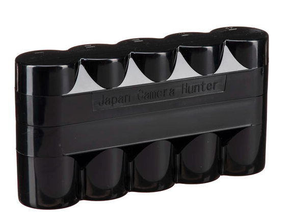

I recommend that when one shoots 120 film that they store the film in film case like this
for 5 or 10 rolls of time to prevent light piping if the roll is not tightly rolled. Nothing to do with your problem which as others have said appear to be air bells.
