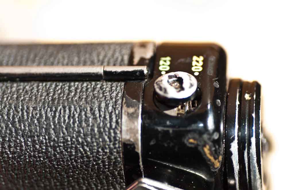

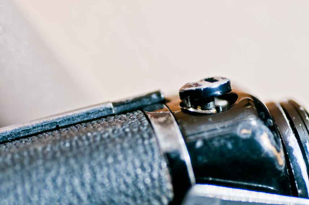

I went ahead and traded with a local shop for a Pentax 6x7 and 90mm f/2.9 lens. So far the way the camera handles is great but there is an issue.the first roll of fill had over lapping frames and some that were too far apart.
Inside the is a pressure plate to change the pressure for shooting 120 or 220 film. there is also a small selector on the right side that switches between 120 or 220. the selector is self explanatory but it sticks up like a mushroom and it looks as though it should pop back down into the recess. If this selector was an issue could it cause the frame spacing to be wrong?
Another thing I noticed is when I load the film and advance the fil to the "start make on the film, it completes the winding stroke closer to the 220 than the 120 mark.

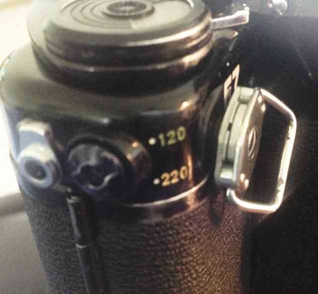

There is a protective collar around my selector, that you do not seem to have.
However I don't think that the selector position should make a huge amount of difference. My understanding of it is that it sets the number of exposures in the exposure counter.
The counter is moved by the movement of film, inside the camera. When I dry fire the camera, the counter does not advance even though I can wind the advance.
However, I am not a Service expert. I do have a copy of the service manual if you need diagrams, etc.

The camera looks mangled, no more so evident that the 120-220 clutch switch — what has been going on here??
And that might be the problem with the frame overlap: the clutch/gear that defines the length of travel (and thus the number of frames that differ from 120-220 film). The switch should be repaired and exposures tested again to ascertain correct frame spacing.
