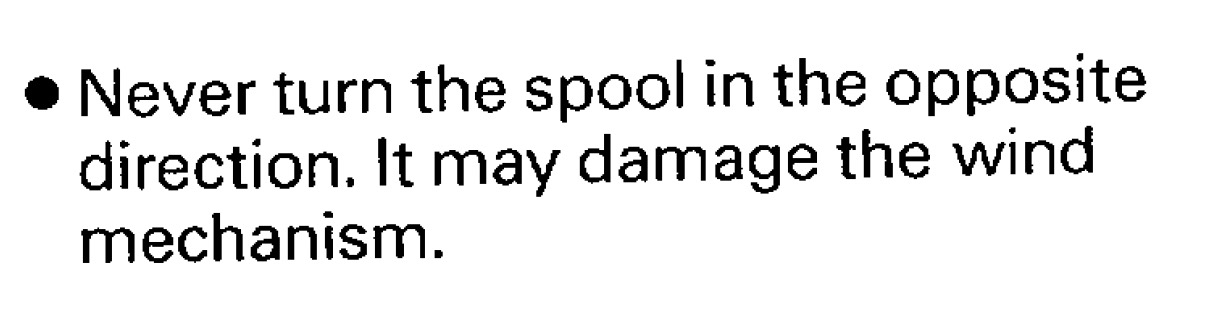

I assume the pressure plate is set for 120 film, that would only affect the winding with the back closed. There is a warning in the manual to never turn the spools in the opposite direction, could that have been done and caused some damage?

You assumed correct on the pressure plate. I can't vouch for how the camera was operated prior to my acquisition. I am aware of that admonishment as well as others concerning the camera.
