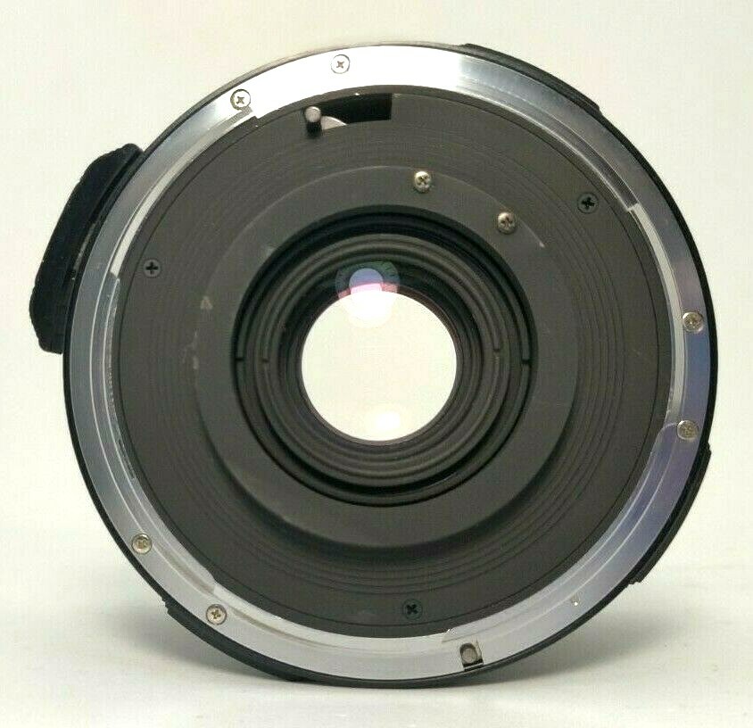

I believe there is a clip on the back on the lens to hold a gel filter. You can see in this image the ring, held on by two screws on one side:
there is a raised portion on one side that you can lift up to slide the gel under. I don’t know how it optically affects the lens, but it was something Pentax designed for.

I'd think twice about that. Doesn't make sense. That looks more like part of the dust-seal system, something you don't want to tamper with. Or else it's a retrofit; why is there a mismatch with all the other screws? (shiny hardware store pan head rather than black recessed - egads! - potential reflections in the image). Any any hypothetical gel would have to be cut down to fit. Nowhere in their lens manuals do they mention internal gel usage. They did market a gel holder for the FRONT of their lenses. By the time the 45 was designed, even using gel filters was getting as arcane a selling leashes for a pet Triceratops. But if someone wants to risk their camera trying that, so be it.
New gels are themselves by no means cheap. There are a lot of cheap used ones or "new old stock" out just a few flavors, many quite possibly faded due to age or improper storage. They're fragile, attract dust, and are hard to clean. Substitute polyester filters are optically inferior, and acrylic resin filters are thick and expensive. You could end up spending more on a flat tire than a brand new one, if you get my drift. Real glass threaded 82's aren't terribly expensive in the overall scheme of things. Deals pop up on those too. There's a fellow across town from me who is a filter liquidator, and has all kinds of odds and ends in stock at reasonable pricing, including 82's. He's at filterfind.net.
You also have to think about it often being harder to focus a WA lens like this with a contrast filter already in position, rather than screwing it in right before the shot. I own all kinds of gels relative to studio and lab application, but never in the field.
There are logical reasons for that. Why turn something simple,basic, and proven into a what-if nightmare?

thats definitely not a hommade retrofit. Its on all the 45's I've seen. Just go to ebay and look at the dozens for sale, most have a shot of the rear, and most give you a good view, and the filter holder is clearly visible in all of them. Again, I'm not saying its a good or bad idea, just that it is highly unlikely to damage the camera unless you put a 4" square gel in there and don't bother to cut it down.

Oh, the fisheye is a very early design, and perhaps their worst optically, but does have built-in contrast filters.The 45 is one of their latest. But thanks for posting the details and correcting me. Not a single P 67 lens of my own, or that I've ever personally seen, has anything like that. But I don't own a 45. Otherwise, no, you're not going to get a 4 inch square gel inside, not even a 2 inch square one. The lens rear simply isn't wide enough. You'd have to cut something way down. Hokey, nonetheless. Seeing that, I'm glad I never bought a 45. If the screws are shiny, a simple black Sharpie pen will solve that for awhile. What their reasoning must have been, is that because of the extreme angle of view in both these instances, the front thread would have been ideally used for a step ring to an even larger sized filter, like a 95, to prevent mechanical vignetting at the edges of the field wide open, just like the wording implies, but somewhat ambiguously, referring just to polarizers, which are not consistent across wide fields of view anyway! I would prefer just to use an 82 front filter and never shoot relatively wide open, and never even bother with a polarizer.

I figured out my confusion over the shiny pan head screws in certain examples of the 45. They probably were blackened originally, but that gradually wore off due to fingers fooling around back there, placing or removing gels.

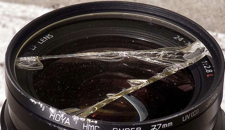

Wratten gels are still a good option. They do not degrade the image at all (as long as they are clean and fingerprint free!). I have even used them in the optical center of many lenses (near the diaphragm) when i plan on using a filter for a lot of shots (such as a #8 when shooting b&w). Having said that, i always keel a uv on the front of my lenses to protect from elements, rain and random bb’s (easier to replace a filter than the front element of your lens).
doctorpepe
Oct 25, 2018
52
New Braunfels, Tx
Sample disaster averted with front filter (not mine, image borrowed from web). In a real life story, i was shooting stage photos for an acting troupe with a 20mm lens close to the director. He gesticulated and when his arm came back, his large jade and silver ring hit sqarely on the front of my lens. Shattered the UV, made a mess, but the front element was unscathed. Rest of the shoot went fine and the Director replaced my filter.
