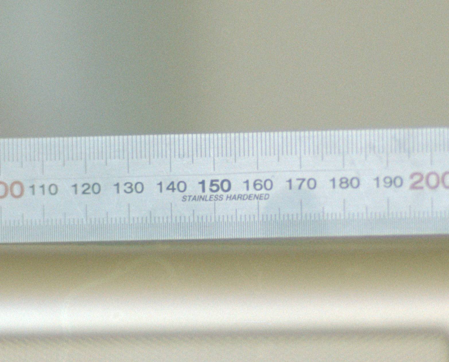

Hi all,
I've discovered while using a 130/2 projector lens that my Pentax 67II has a slight front focusing issue. How can I fix this? By adjusting the mirror?
Cheers
Peter
