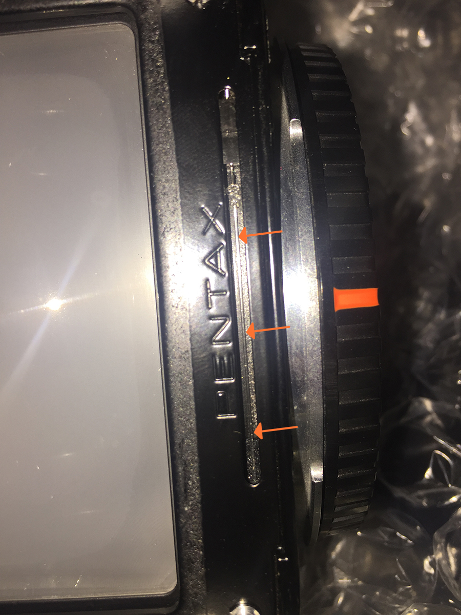

I bought this off eBay in great condition and I took off the TTL finder to inspect the chain of the Pentax 67 (416xxxx serial). It doesn't have any links that look like a chain, instead it just looks like a thin wire:
attachment.php
Please tell me if this is abnormal and if I should return this to the seller. The item described this as fully functional and near mint condition so I am not sure why this chain is not a chain...here is what a google images search shows the Pentax 6x7s one (which isn't the 67 but I assume the chain should be the same):
attachment.php
Thoughts?!

Update: here is a video of me testing out the lever inside the lens mount to see if the chain moves:
[video]https://vid.me/e/MZVP[/video]
Functionally seems okay but visually it doesn't look like a chain with links, just a skinny wire...any ideas?

It makes me squirm to see a repair like that. It may or may not be reliable — have you run tests for exposure and coupling with the meter?*
Pentax never made nor recommended a solid or braided wire as replacement for the original meter coupling chain and replacing the original chain with a solid wire actually can lead to jamming of the mechanism. A replacement is always a linked chain, as per the original (the Pentax 67 bodies had a better and stronger chain fitted). I would also be asking the seller for evidence that the lens flange has been re-calibrated due to the loss of tolerance during disassembly and reassembly. It doesn't look like a professional service bench repair to me so... perhaps communicate with the seller and ask who (if not himself!) carried out the repair and furnish evidence that the flange has been recalibrated.
Like the very thin nylon cord in the Olympus OM4, these chains can and do break for a good reason!
* When removing the prism and before re-mounting it: remove the lens. Re-mount the prism and then re-mount the lens.
This resets the position of the meter coupling pin in the prism to the chain on the camera body. If this procedure is not followed, stress is imparted on the chain and eventually it will break. I'm wondering if the original owner couldn't be bothered taking notice of this procedure and decided on a solid wire replacement. It will take more stress, but it will still break, and potentially break other parts of the mechanism as a flow-on.

The original version indeed uses a chain. As the chain is spring loaded at one end and actuaded by a lever at the other end it is only to to move a slider for and back and no sprocket wheels are involved, it basically is only a flexible means to transfer a movement around a bent path.
A thick wire could induce some lag at bents. With a thin steel wire as yours I do not see such problems. In theory a chain would hold on longer, but the fact that it had been substituted indicates the contrary.

Aw man now I'm definitely worried, I had a hunch that this camera was broken and repaired since only the body was for sale. I can't even afford to send this back to Japan right now. I have not yet run tests for exposure since my 105mm lens is still in transit, though when I flick the TTL finder power switch to "on" nothing lights up inside to indicate any form of life...do you know if a lens is required for the meter to activate? The battery check light turns on so I assume battery is not the issue. These Japanese sellers are difficult to communicate with since their English is not so well, but I will ask him for evidence...without expecting much help (what evidence could he provide anyway?). If the flange has not been recalibrated well, how would I know? I am wondering how to test this properly...am I supposed to shoot some test rolls at different apertures to see if the meter is accurate or something? And if the images come out looking good? Thanks for your advice, you guys are all I can rely on right now.
Yes I hope you are right, but the fact that someone tampered with this really makes me nervous. I bought this from a camera store on eBay and was hoping I wouldn't have to deal with issues like this...ugh!

From my point of view, the repair was done like this because, probably, the meter coupling chain broke on several occasions, likely due to a lack of observation of the noted procedure of removal of the prism etc. He/she wanted to "put a stop to the nonsense", to coin a phrase. If that (admittedly idiosyncratic) procedure is done incorrectly often enough, the chain will break, period.
Without a lens mounted, the meter has nothing to couple it. If, however, a lens is mounted and the meter is turned on and you see no response, then a more detailed investigation would be needed.
Flange calibration is not critical, but it is an additional step in the post-assembly. Follow this link to see the steps involved:
http://www.salzgeber.at/articles/6x7chainRepair.html
As a rule, a personal one at that, I totally avoid dealing with Japanese sellers with a poor grasp of English. It's not that I have an inherent trust of Japanese folk, it makes me very uncomfortable trying to make sense of mangled English and to establish clear facts. The best option is to skip over the offenders until you land on one that is obviously bi-lingual (and a lot of Japanese are).
The re-calibration process is technical. This snip is from page 92 of the Pentax 6x7 Repair Manual:
