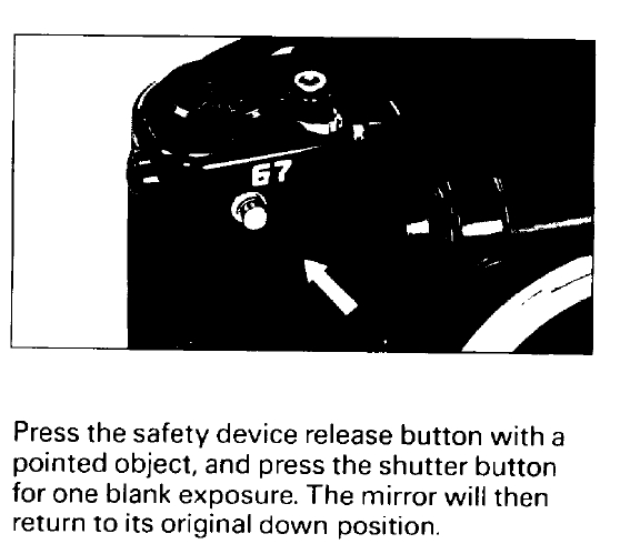

a. The mirror locked up can be released by depressing a tiny black button on the front left ( if you are facing the camera ) and then hitting the shutter button.
see attached image

We may be talking of 2 different buttons related to MLU. The slide button at the lens mount point is the MLU trigger. Push this one just before firing the shutter button. The other button mentioned is the very small round button mounted on the body front, just below the shutter release button. This will unlock the mirror if it is in the up position and requires a pointed object to press it easily.

Pressing the shutter cycles the shutter and the mirror then returns to its normal down position. The small button is for unlocking the mirror if it is in the up postion and not releasing Also, if you put a battery in with the mirror in the up position, the battery will drain as long as the mirror is up. The safety button allows you to unlock the mirror in this case.

then 3. Their seems to be a second little button that unlocks the mirror.
I found it and when pressing nothing happens.
As quoted above, the mirror should return to it's original position right? The same effect as takin a photo withouth actually exposing film, right?
well as said. Nothing happens. Still can't see a thing looking through the camera, which indicates the mirror is still flipped up.
So what does the button actally do, as it is not bringen the mirror back? and what should be done?
Sorry but someone has to describe this in a very overdone way. I am not to slwo understanding these kind of things. normally that is :smile:
Thanks a lot everyone so far.
Bet regards SAM
Karate Dad
Jan 5, 2005
23
Connecticut,
My only suggestion is to make sure you are fully depressing the button. I usually use a toothpick or something similar. The only time I have had the mirror not return was whenever I was having battery problems. In those cases I had to remove the battery.
