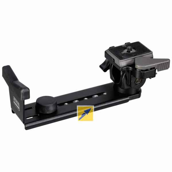

Hi there,
Do you mean such type ? :
with regards
DREW WILEY
Jul 14, 2011
13,686
8x10 Format
Na. Bolted both positions onto something WAY more solid than that. The 300's need better support than my 8x10 camera. I made it from a bar of hard maple, then pickled it with penetrating marine epoxy for stability, which I deliberately discolored with rust powder etc to match the vintage weathered look of my big Ries maple tripod. Gotta look cool, and not like geek gear! But I also laminated dense phenolic to the top of the block. It sits right atop the big Ries platform, using the standard 3/8-16 turn knob. If I do need to orient the camera vertically, I have one of those heavy ole Bogen cast iron pan/tilt heads. If you happen to prefer ballheads, use em for a boat anchor - worthless in this scenario.
