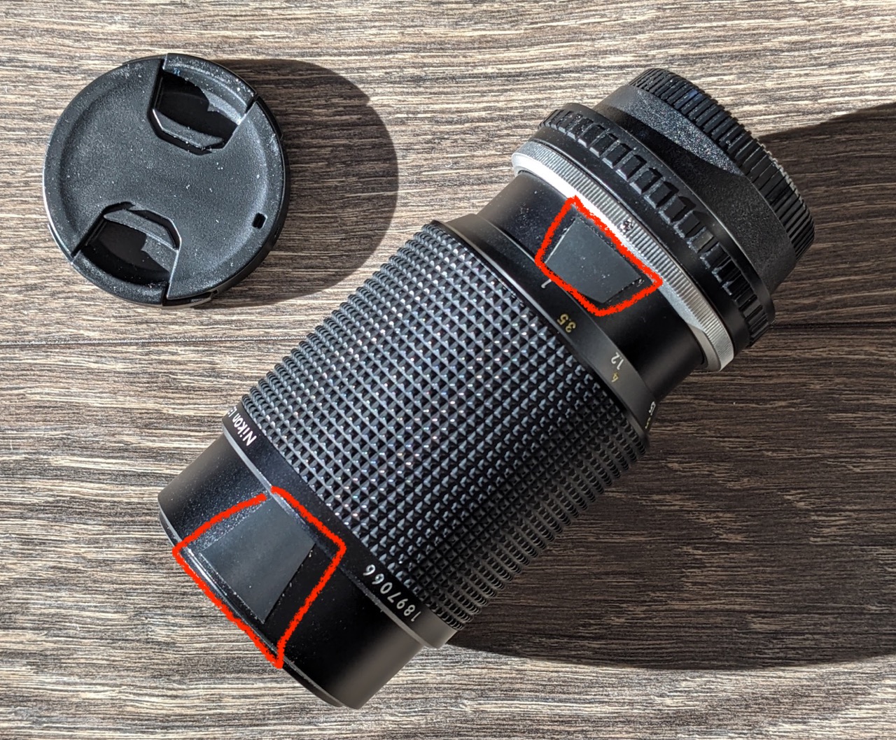

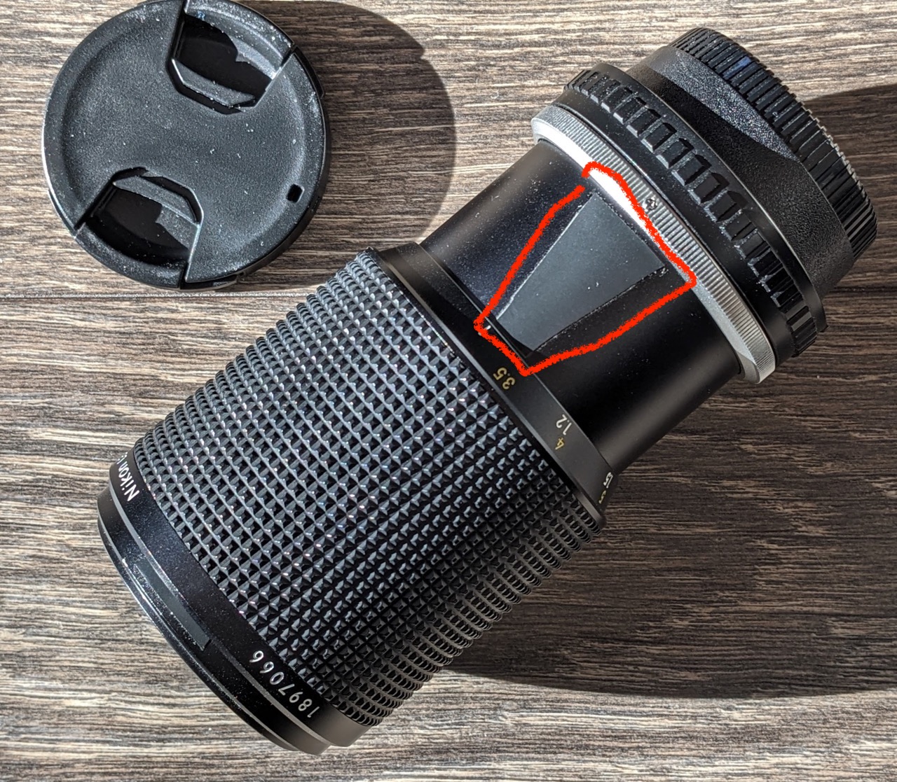

My version of 135/4 Macro for P67 is the later SMC Pentax type, and does not exhibit this problem. But focus creep or zoom creep is an easy fix, by yourself.
You just need black electrical tape, cut them into trapezoid shape, and stick to the focusing/zoom helicoid. You need to experiment with the length and width of the tape. Sometimes you might need to apply it to both sides. One visual example of Nikkor 75-150/3.5 Series E lens, which suffers from zoom creep, with the tape on.

The electrical tape is a great idea. I had used rubber bands in the past, and they worked, but it wasn't the best solution. This tape idea looks much better.

A technician can replace the focusing helical grease for a stiffer one.
But to tape the barrel with electrician tape sounds, to me, a more practical proposition...
